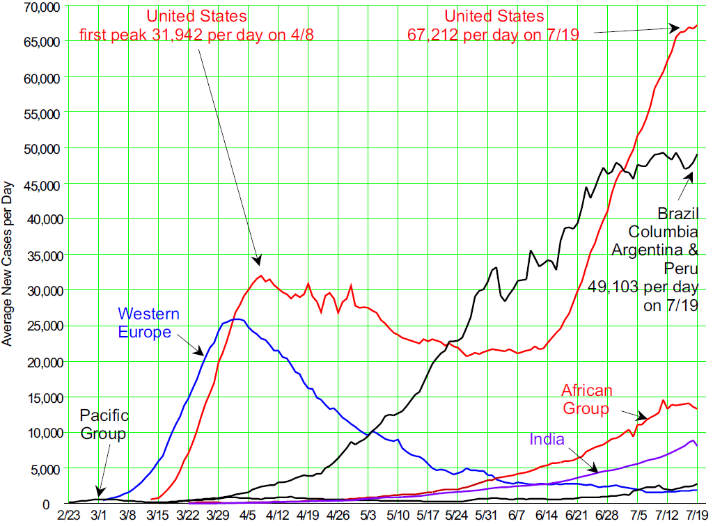

With data that come along one number at a time, it is easy to get lost in the details. To see the big picture, it helps to use a time-series graph that will draw your eye in the direction that your mind wants to go. These simple graphs reveal how the values are changing over time and thereby place each value in context, making them more easily understood. Here we will look at some time-series that provide a global perspective on the Covid-19 pandemic.
Comparable numbers
With 329 million people, the United States is the third largest country in the world. China and India have more than four times the population of the United States, and fourth-place Indonesia has only 82 percent of the population of the United States. These size differences make direct comparisons misleading, which is why data are often normalized and expressed as rates per million population. While these rates provide an equitable basis for making comparisons, the per-capita rates are one step removed from the original values. A conversion is required to turn these rates into values we can expect to see in practice. This conversion is not complicated, but it nevertheless creates an obstacle for readers to either hurdle or stumble over.

Figure 3 of your article tells the whole story. Using the original data along with rational grouping makes it all more powerful.

Let's examine the testing hypothesis as an explanation of the magnitude of the discrepancy between Covid 19 data from the US versus the rest of the world.
1) Are we really testing that many more people than the rest of the world? Admittedly, expressed as rates per million people, we test a lot- but no where enough more to account for the magnitude of this difference.
2) If testing were a reasonable explanation for the number of cases we report, it should show up in our positivity rate. It doesn'.
3) I testing accounted for most of the difference between our case reports vs other countries, then changes in our testing rates should co-vary with the magnitude of the differences between the cases reported by US vs other countries. It doesn't. We continue to pull away from the pack regardless of what testing policy is in place at any given point in time.
4) I will refrain from commenting on our "transparency"as a possible explanation for our supremacy within the international community by noting that this administrations recent attempt to divert data from going directly to the CDC was reversed only after it became publicly known and caused a severe backlash.

Every day I look at the European CDC database and extract the values for 30 countries around the world.
The population data they use comes from the World Bank, and is sufficiently accurate for the way it is used here.
This means that the counts of confirmed cases create lower bounds for the infection rates.
Think about this very carefully! The number of tests given in the different groups are not sufficiently differnet to explain the 37-fold difference found between Europe and the U.S.
