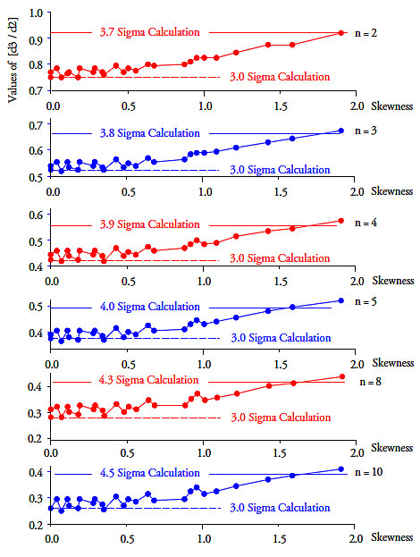

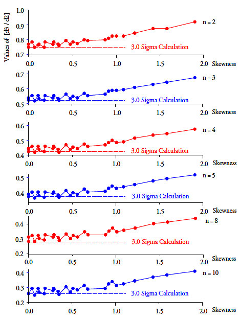

Whenever the original data pile up against a barrier or a boundary value, the histogram tends to be skewed and non-normal in shape. Last month in part one we found that this doesn’t appreciably affect the performance of process behavior charts for location. This month we look at how skewed data affect the charts for dispersion.
In practice, we get appreciable skewness only when the distance between the average and the boundary condition is less than two standard deviations. A careful inspection of the six distributions shown in figure 1 will show that this corresponds to those situations where the skewness is in the neighborhood of 0.90 or larger. When the skewness is smaller than this, the departure for normality is minimal, as may be seen with distribution number 15 in figure 1.
The usual formulas for finding limits for a range chart involve the scaling factors known as D3 and D4.
Lower Range Limit = D3 × Average Range
Upper Range Limit = D4 × Average Range
These scaling factors depend on the bias correction factors, d2 and d3.
