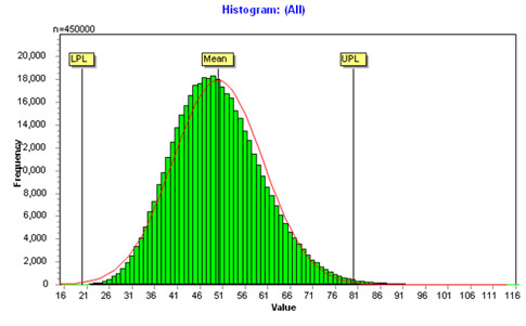

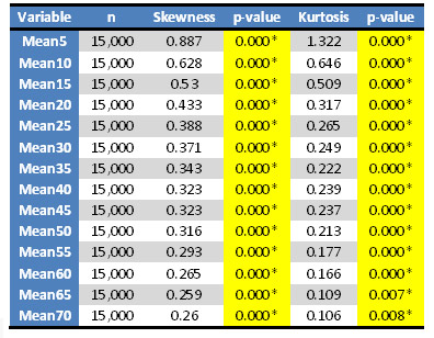

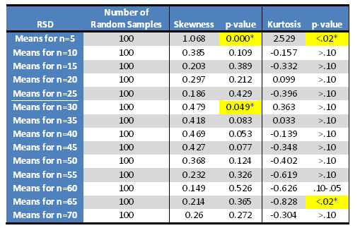

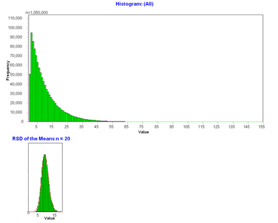

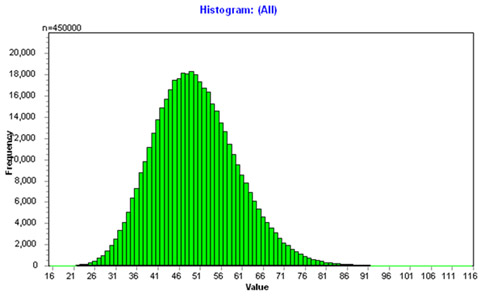

Throughout the last couple of articles, I have explained and illustrated that understanding the random sampling distribution (RSD) of a statistic is key to understanding the entire basis of inferential statistics. Which is just a fancy way of saying “avoiding career-terminating decisions.” This month I’ll show you how the central limit theorem is your best friend, statistically speaking.
