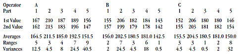

It would appear that there is still considerable confusion regarding which method to use in evaluating a measurement process. There are many voices speaking on this subject, however, most of them fail to use the guidance provided by statistical theory, and as a result, they end up in a train wreck of confusion and uncertainty. Here the three most common methods will be compared side by side.
Our example will use the data obtained from a gauge used to measure gasket thicknesses in mils. Three operators measure five parts two times each to obtain 30 measurements arranged into 15 subgroups of size 2 as shown in figure 1. To understand these data it is helpful to observe that the operator-to-operator differences show up between the subgroups, the part-to-part differences show up between the subgroups, and the test-retest error shows up within the subgroups. This organization is the key to interpreting these data.
Figure 1: The gasket thickness data. Click here for larger image.

d*2
It is important to note that d*2 is emphatically NOT the same as the d2 control chart factor, except for very high degrees of freedom (in which case they become identical). The table is available in the AIAG MSA manual.

Thought I was losing my mind, seeing phantom bias correction coefficients used by Wheeler that don't match up with the standard charts.
