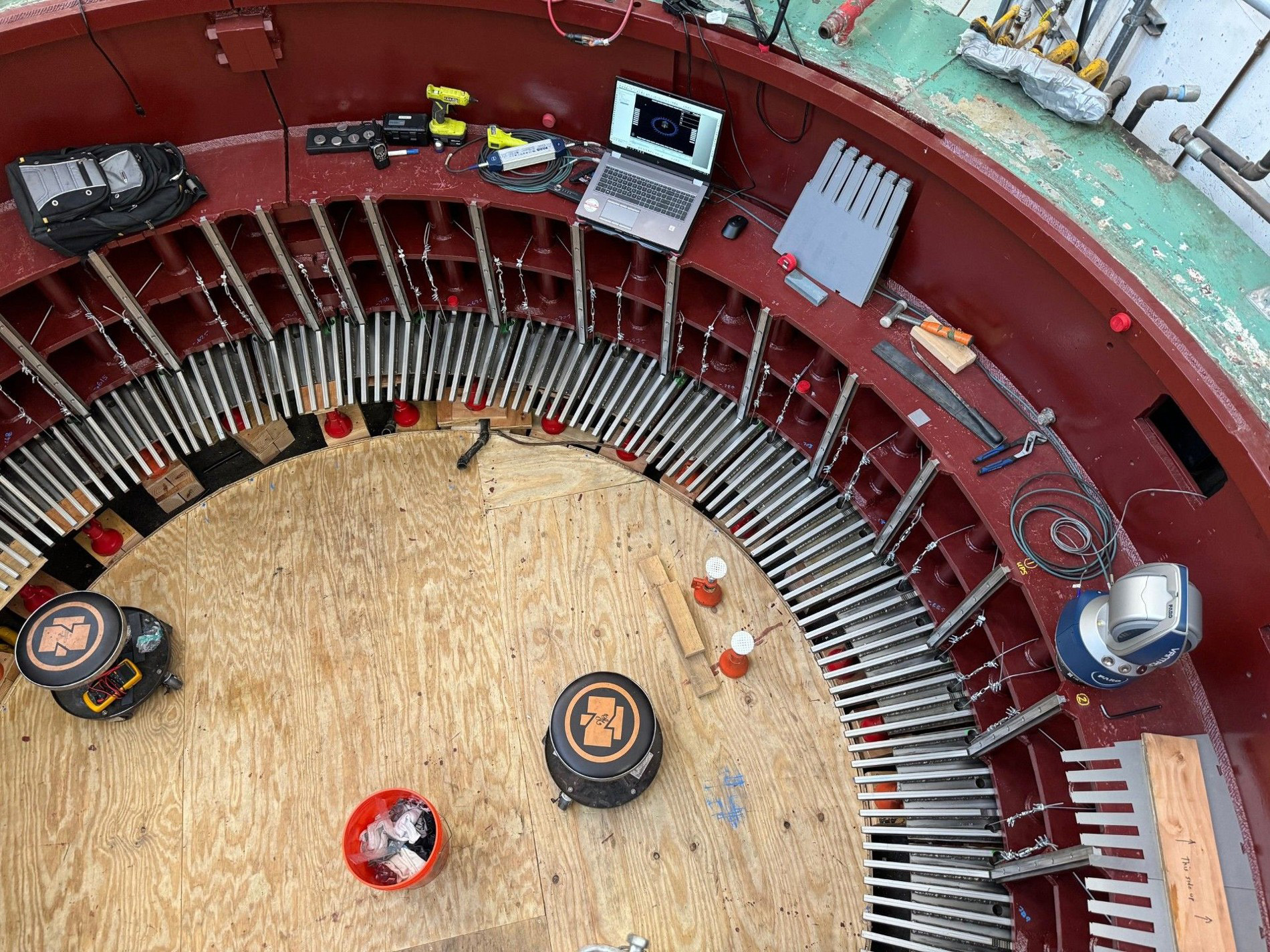

Hydroelectric generators are used to generate power in many parts of the United States. One of their interesting details is that despite how massive they are—a typical 5–20 MW generator can measure 8–12 ft in diameter and weigh about 50 tons—they are built to extremely demanding tolerances.

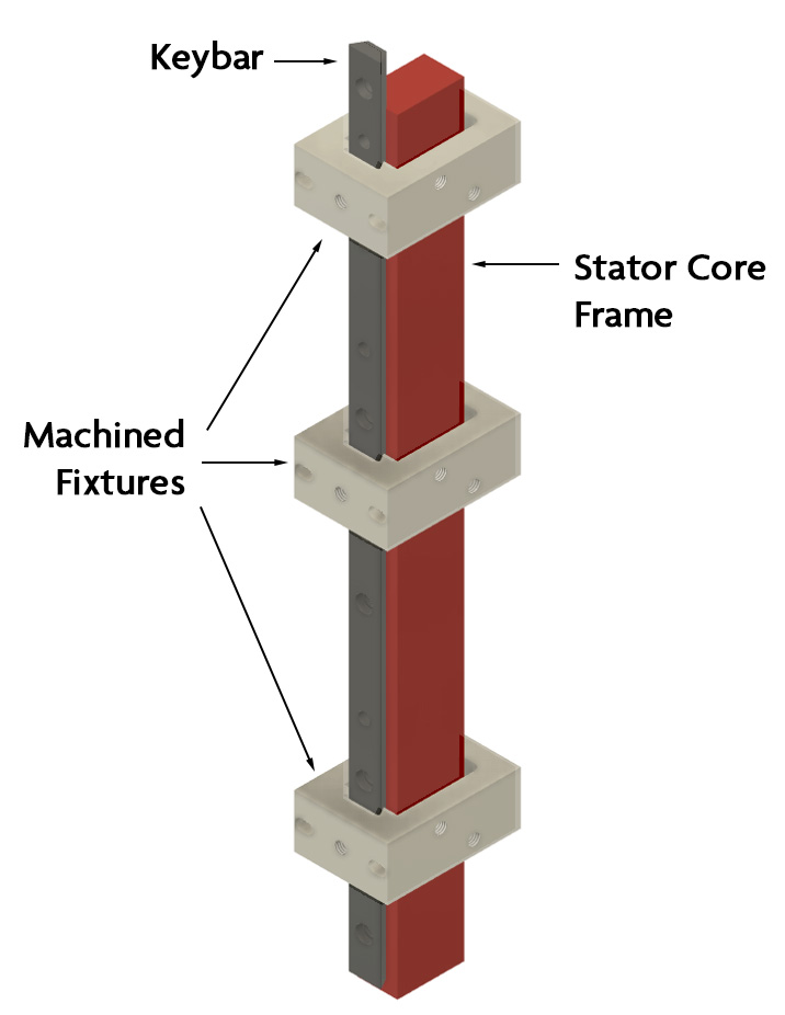

My company, BMI, was contracted to install new keybars in a hydroelectric generator stator frame. The stator frame houses the stator core that sits inside the generator. The keybars act as structural components to ensure the massive iron core is kept within the roundness tolerance.
Keybar manufacturing tolerances are tight, at this particular installation about 0.005 in. radius over the 24 in. keybar length. During installation, a series of fixtures are needed to hold the keybars in place and allow adjustment in and out, side to side, and to control twist during assembly so the stator’s inside diameter is held to a tolerance of +/– 0.01 in. over the 8–12 ft diameter.
Overall top-end view of hydroelectric generator. Stator frame is red. Keybars are the gray vertical pieces.
In addition to the dimensional challenges, the working environment requires that all fixturing be adaptable to field conditions where access, alignment consistency, and repeatability are often limited. Furthermore, because the work site is highly regulated and in a remote area for generating power, as the service provider we need to know we have the correct dimensions while we’re onsite to understand how to best join the keybar set to the generator’s stator core.

Fixtures holding the keybar and stator frame in place
Our field engineer first designed the two-part modular fixture components based on the onsite understanding of what was needed. The designs were reviewed collaboratively between engineering and field technicians to ensure usability and installation feasibility. The fixture components were then exported to a remote Bambu 3D printer.

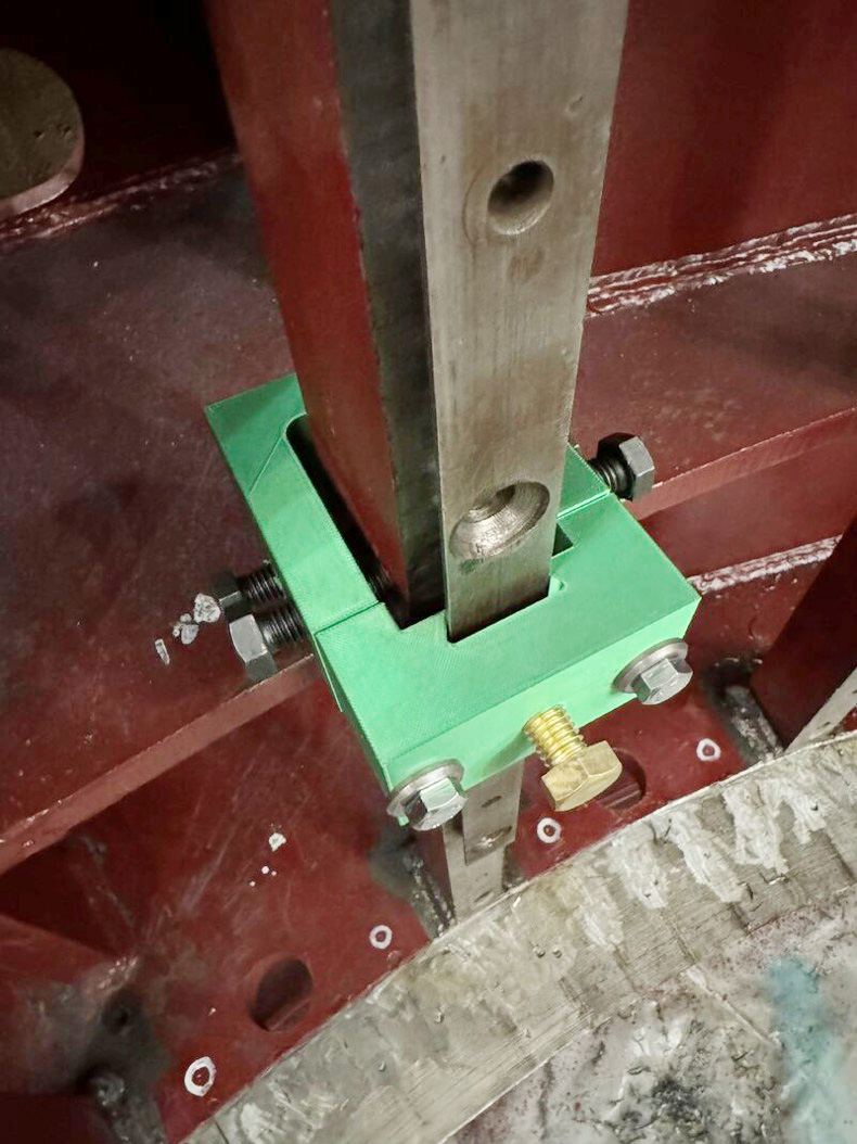

3D-printed fixture (green) for testing on stator core
Upon completion, the 3D-printed parts were overnighted across the country to the generator site, hand tapped, and installed to complete proof of concept as seen here.
This rapid turnaround enabled immediate validation of:
• Fitment within the stator geometry
• Adjustability range of the fixture
• Repeatable alignment under installation conditions
• Ease of use for installation technicians
The ability to physically test these components in real-world conditions significantly reduced uncertainty before moving into final production.

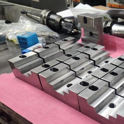

Machined fixture components
The last step in the process was to work with our CNC machining vendor to complete the expedited parts from steel. The validated additive design served as the “nominal model,” ensuring that the machined components required minimal rework or redesign.
Start to finish, from 3D print to machined parts, was less than one week.
