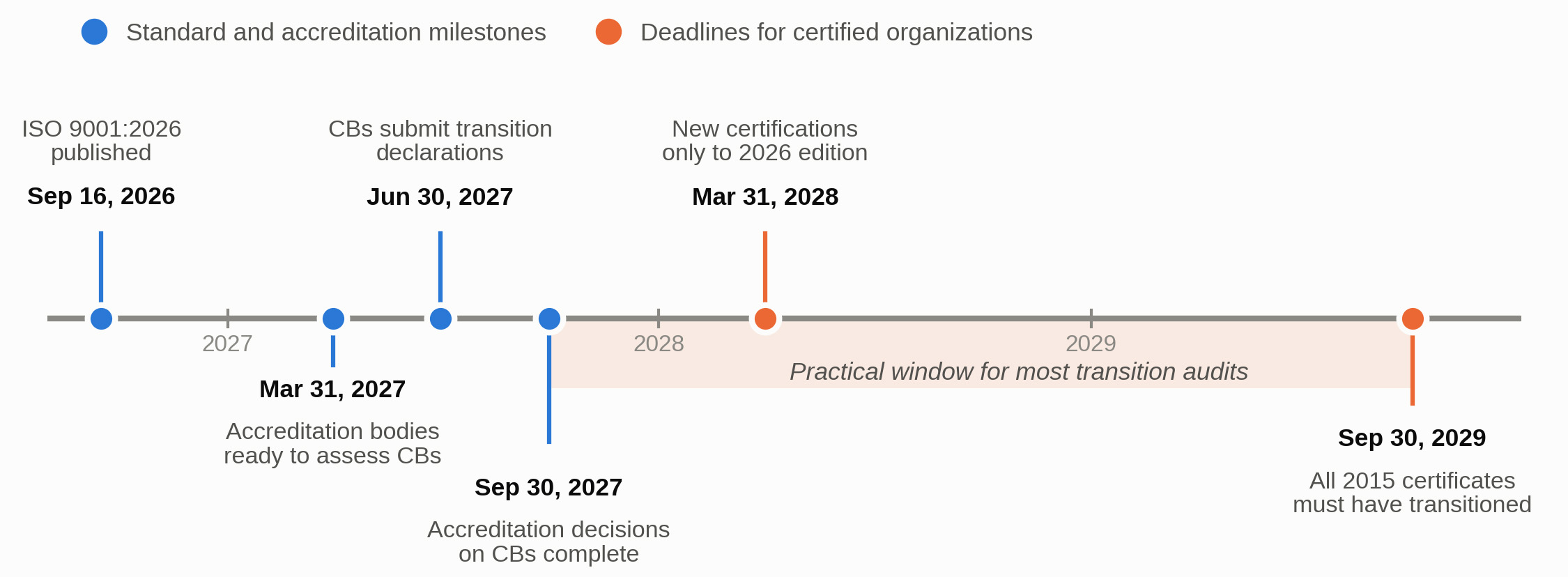

The dates that matter, and why three years is shorter than it looks
The transition rules for accredited certification are set by Global ACI, the international cooperation of accreditation bodies. The milestones are:
• Sept. 16, 2026: ISO 9001:2026 published.
• March 31, 2027: accreditation bodies ready to assess certification bodies against the new edition.
• June 30, 2027: certification bodies submit their transition declarations.
• Sept. 30, 2027: accreditation bodies complete their transition decisions.
• March 31, 2028: new and initial accredited certifications can only be issued to ISO 9001:2026.
• Sept. 30, 2029: all ISO 9001:2015 certificates must have transitioned.
Figure 1: The ISO 9001:2026 transition timeline. Source: Global ACI transition requirements for ISO 9001:2026
Read those dates from the certified organization’s side. Your certification body can’t issue an accredited 2026 certificate until its own accreditation body has assessed it, and for many that won’t happen until sometime in 2027. The real window for transition audits is closer to two years than three. On a normal three-year certification cycle, that leaves most organizations one or two scheduled audits in which to make the move. Leave it late, and you’ll be competing for audit dates with everyone else who did the same.

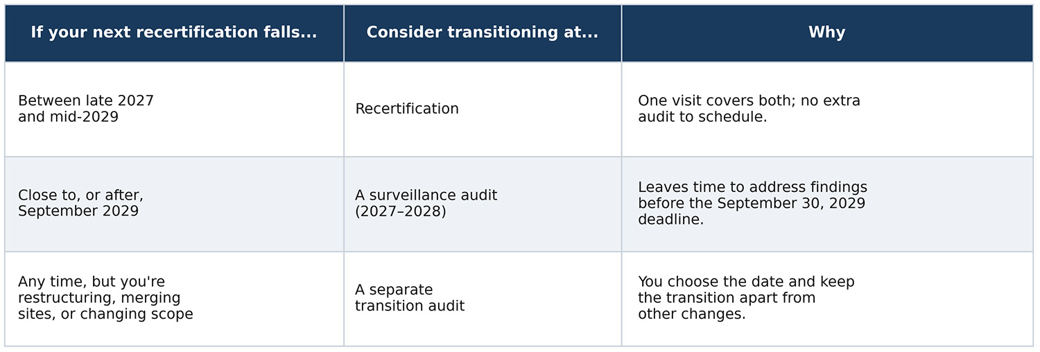

Choosing your transition route
The transition can happen at a scheduled surveillance audit, at recertification, or in a separate transition audit. Which one fits depends mostly on where you sit in your cycle:
• Recertification between late 2027 and mid-2029. This is often the natural point. The transition is assessed alongside the full recertification, and you avoid an extra visit.
• Recertification close to, or after, September 2029. Don’t wait for it. A recertification in the summer of 2029 leaves little room to address any nonconformities before the deadline. Transition at a surveillance audit instead.
• Timing that doesn’t line up, or a major change underway. A separate transition audit costs an extra visit but lets you choose the date, which can be worth it if you’re also restructuring, merging sites, or changing scope.

Figure2: Which transition route fits your certification cycle?

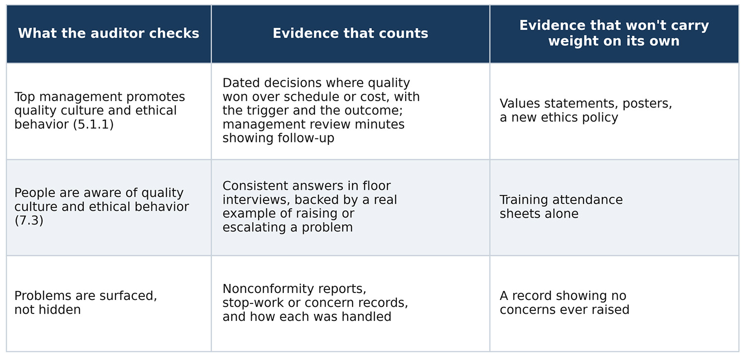

Leadership, quality culture, and ethical behavior (5.1.1 and 7.3).
This is the change people find hardest to picture at audit. The 2026 edition requires top management to promote quality culture and ethical behavior, and requires people doing work under the organization’s control to be aware of both. Neither can be proven with a document. A values statement, a poster, or a training attendance sheet shows that the words exist, not that anyone acts on them.
So how does ethical behavior actually get audited? Through what people do when quality conflicts with something else: schedule, cost, or a customer’s deadline. Expect the auditor to work from three directions.
Top management decisions: The auditor will ask for a recent, dated example where leadership chose quality over convenience, such as holding a shipment, refusing a supplier shortcut, or changing a target that was driving the wrong behavior, and what triggered it. Management review minutes that record these decisions and their follow-up are strong evidence.
 Interviews on the floor: Operators, inspectors, and engineers will be asked, in their own words, what they would do if they saw a problem that would delay an order, and whether they have ever done it. Consistent answers across shifts and departments, backed by a real example, say more than any policy.
The escalation trail: Nonconformity reports, stop-work records, concerns raised, and how they were handled. An organization that reports no concerns at all will prompt more questions, not fewer.
What won’t satisfy the requirement is a new ethics policy written the month before the audit. What will is a short, honest record of decisions and behaviors that already happen, with management review showing that leadership is paying attention to them.
In one audit, I found that the organization’s internal audit had missed a process that should have been included in the audit program. What stood out was the response from senior leadership. Rather than treating the nonconformity as something to close for the audit, they wanted to understand why the process had been missed, correct the internal audit approach, and make sure the management system was properly aligned with the standard going forward. For me, that response was stronger evidence of quality culture than any policy or training record.
Figure 3: Ethical behavior and quality culture—evidence that counts at audit risks and opportunities (6.1).

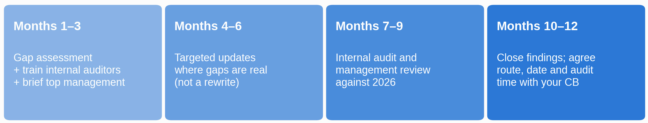

A month-by-month plan for the first year
Months 1–3: Get the standard and run a clause-by-clause gap assessment against the 2026 text. Train your internal auditors, and brief top management, who are the people an auditor will interview about Clause 5. Ask your certification body for its own transition timeline.
Months 4–6: Make targeted updates where the gaps are real, typically the risk-and-opportunity process, leadership responsibilities, and the climate determination. Resist the urge to rewrite the manual.
Months 7–9: Run an internal audit against the 2026 requirements and hold a management review that explicitly covers the transition, with actions and owners.
Months 10–12: Close the internal audit findings and agree on the route, date, and audit time with your certification body.
Figure 4: A four-phase plan for Year 1
An organization that follows this plan will walk into its transition audit with a year of evidence that the updated system is working, which is exactly what the auditor is there to see.

Quality Culture / Ethical Behaviour
This is one of the most important features of a successful quality system, yet one of the most difficult ones to measure and assess. A dogma on quality management is that what can't be measured can't be improved. I agree on that when applied to quality control, where you actually do product and/or process characteristics measurements. But when you are talking about the cultural and ethical portions, measuring it accurately is more than a challenge. I agree with the approach stated in this article (assessment to be based on examples rather than procedures). I would add the following: training on the matter is a must and top management yearly review should include a chapter for a review on instances of poor quality culture/ethical behavior and including an action plan. I would later on (years to come) like to see structured procedures as well.
