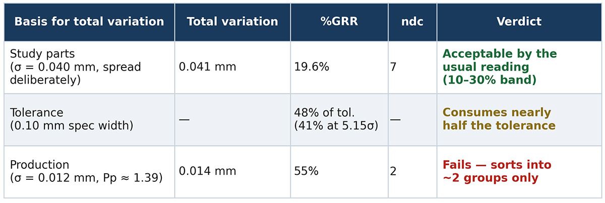

A shaft diameter is specified at 10.00 mm ± 0.05 mm, so the tolerance is 0.10 mm wide. The gauge is a digital caliper that reads to 0.01 mm. For the study, someone pulls 10 parts from the line and the reject bin so the set covers the full range. The parts run from about 9.94 to 10.06 mm.
The study returns a measurement standard deviation (repeatability and reproducibility combined) of 0.008 mm. The part-to-part standard deviation across the 10 study parts is 0.040 mm.
Total variation is the square root of 0.008 squared plus 0.040 squared, about 0.041 mm. So %GRR is 0.008 divided by 0.041, or 19.6%. The number of distinct categories, 1.41 times the part standard deviation over the measurement standard deviation, comes out at 7. The usual minimum is 5.
By the usual reading, this caliper is acceptable. It sits in the 10%–30% band, and ndc clears the bar. Most reports stop here.
The same gauge against the tolerance
Now ask a different question. How much of the tolerance does the measurement spread consume? The current AIAG manual uses six standard deviations for this. Six times 0.008 is 0.048 mm, which is 48% of a 0.10 mm tolerance. Older worksheets use 5.15 standard deviations and give 41%. Either way, the measurement spread eats close to half of the tolerance.
The study parts didn’t change. The gauge didn’t change. Only the denominator did.
The same gauge against production
Now suppose the process is capable and centered. The real part-to-part standard deviation in production is 0.012 mm, not 0.040 mm. That is a Pp of about 1.39, which most customers would be glad to see.
Recalculate %GRR with the production spread as total variation. The square root of 0.008 squared plus 0.012 squared is about 0.014 mm. %GRR is now 55%. The ndc drops to 2, which means the caliper can sort production parts into roughly two groups. At that point it works as a go/no-go check, not a measuring instrument.
It also distorts what you think you know about the process. Measurement variation adds to process variation, so the observed spread is 0.014 mm rather than 0.012 mm. The same capable process, measured with this caliper, reports a Pp of 1.16 instead of 1.39. Teams chase that gap on the machine when it lives in the gauge.
Figure 1: How %GRR changes with what you compare it to. Same gauge, same measurement standard deviation (0.008 mm)—only the denominator changes.

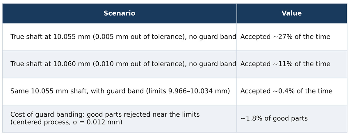

Averages hide the cost, so take one part. A shaft that is truly 10.055 mm is 0.005 mm out of tolerance. With a measurement standard deviation of 0.008 mm, a single reading will land at or below 10.050 about 27% of the time. Roughly one in four of those parts gets accepted. A shaft at 10.060 mm still passes about 11% of the time.
If your process runs well centered, few parts sit that close to the limit, and the real-world risk is small. If the process drifts toward one side, or the characteristic is critical, that 27% is the number that matters.

Guard banding keeps the gauge and tightens the acceptance limits instead. With limits of 9.966–10.034 mm (two measurement standard deviations inside each specification limit), the shaft at 10.055 mm is accepted about 0.4% of the time instead of 27%. The price is good parts rejected near the limits. In this example, with a centered process, about 1.8% of good parts would fail inspection. Whether that trade is worth it depends on what an escape costs you.

Figure 2: Risk and guard-banding outcomes. Measurement standard deviation = 0.008 mm; specification 10.00 mm ± 0.05 mm.
