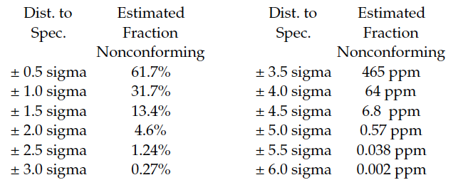

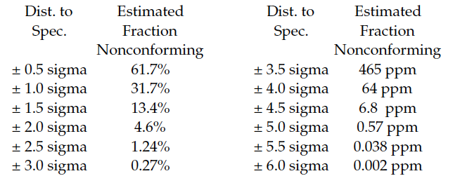

In the days before handheld calculators and personal computers, students in SPC classes were taught to estimate the fraction of nonconforming product by converting each specification limit into a z-score and then looking up the fraction nonconforming using a standard normal distribution. Since the normal is the distribution of maximum entropy, this approach would, in most cases, yield worst-case estimates for the fraction nonconforming. Figure 1 shows these traditional fractions nonconforming for symmetric specifications spaced at different distances from the mean.
Figure 1: Traditional sigma levels
The first thing to note from Figure 1 is that the estimates are spread out over nine orders of magnitude. This will complicate the job of obtaining reliable estimates.
