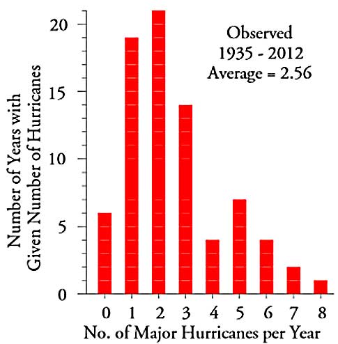

All data are historical. All analyses of data are historical. Yet all of the interesting questions about our data have to do with using the past to predict the future. In this article I shall look at the way this is commonly done and examine the assumptions behind this approach.
A few years ago a correspondent sent me the data for the number of major North Atlantic hurricanes for a 65-year period. (Major hurricanes are those that make it up to category 3 or larger.) I have updated this data set to include the number of major hurricanes through 2012. The counts of these major hurricanes are shown in a histogram in figure 1.
Figure 1: Histogram for the number of major North Atlantic hurricanes 1935–2012

Histograms?
Historgrams? ha. Those are bar graphs. And you people call yourselves "quality".

Histograms
https://en.wikipedia.org/wiki/Histogram
