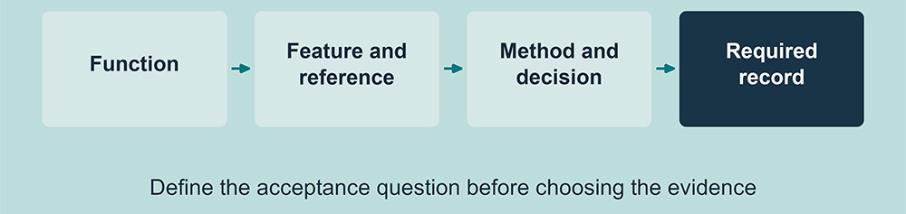

Figure 1: Chain from function to feature and datum, measurement approach, acceptance decision, and record requested.
Begin with function and a stable specification
Choose inspection features from the part’s intended function and risks. A shaft may locate in a bore, seal against a shoulder, or transmit torque through a flat. Those functions point to different characteristics: diameter, runout, axial position, surface condition, or orientation. The drawing should make the requirement and datum relationship clear enough for a supplier to interpret.
Before adding reporting demands, verify that the applicable drawing revision, units, general tolerances, and notes are consistent. If a CAD model accompanies the drawing, explain which file controls when values conflict. A model is useful for geometry, but the drawing or specification may contain limits and surface or material notes needed to judge the part.

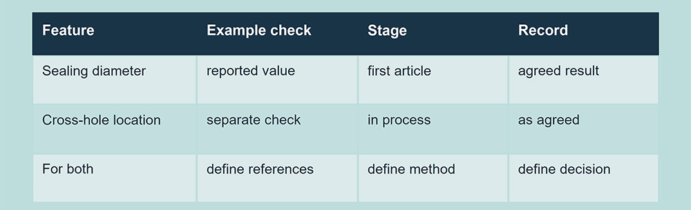

A concise feature plan can list characteristic and drawing callout; functional reason; datum or setup reference; acceptance requirement; check stage or sample frequency; required record; and decision rule if specified. Mark unresolved items as questions rather than filling them with assumptions. Revise the plan with the supplier when measurement reveals an ambiguity.
Consider a hypothetical turned component with a sealing diameter and a cross-hole. The buyer might request a reported value for the sealing diameter on a first article and agree on a separate in-process check for cross-hole location. This illustrates how evidence can differ by feature; it doesn’t prescribe a frequency or describe a real customer program.
Figure 2: A hypothetical plan distinguishes the sealing diameter from the cross-hole location and assigns a check stage and evidence to each.
