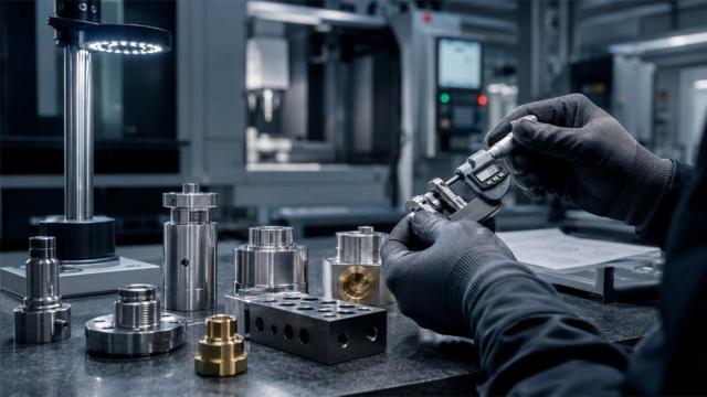

Define Inspection Features and Evidence Before Requesting Quotations Clear feature requirements help suppliers plan measurement. Buyers understand what a reported result establishes.
Mon, 11/02/2026 - 12:03
Consider a hypothetical turned shaft with a diameter specified as 20.000 mm ± 0.010 mm. The supplier reports 20.009 mm, just inside the upper limit of 20.010 mm, with an expanded measurement uncertainty of 0.003 mm. The buyer puts the shipment on…
