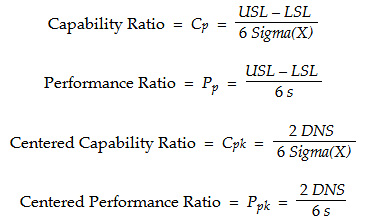

Four indexes in common use today are the capability ratio, Cp; the performance ratio, Pp; the centered capability ratio, Cpk; and the centered performance ratio, Ppk. The formulas for these four ratios are:
To understand these ratios we need to understand the four components used in their construction. The difference between the specification limits, USL – LSL, is the specified tolerance. It defines the total space available for the process.
