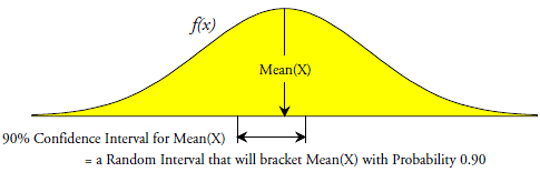

Last month we considered the theoretical and practical aspects of finding a confidence interval for the mean. On the theoretical plane this involved finding the formula for a random interval that would bracket the mean value with some specified probability. In figure 1 this probability which is shown as 90% is the value commonly known as the "confidence level" for the interval estimate.
Figure 1: A 90% confidence interval for the mean
