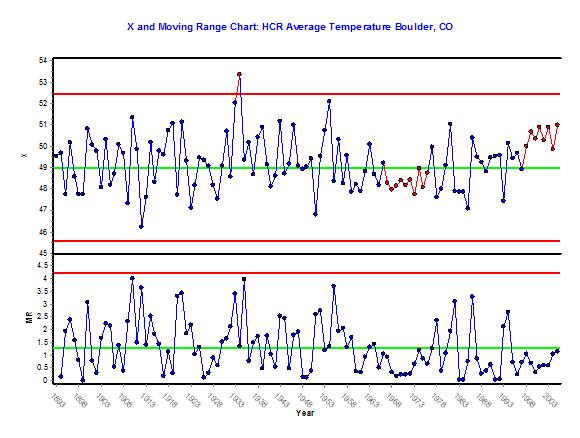

If I plot the data on an individuals and moving range chart, I get the following graph:
Figure 1. X & MR Chart with μ = X-bar
As usual, first we look at the dispersion chart. With the moving range, we look only for points outside the upper control limit (because the moving ranges aren’t independent), and conclude that, as far as we can tell, the year-to-year variation is predictable.
Looking at the individuals chart, we see three unusual patterns. The first is that the year 1934 in Boulder was abnormally warmer than expected. (Personally, I think it’s because that is the year that Cole Porter’s Anything Goes heated up Broadway. Not sure how it got to Boulder, though.) The next is a run below the mean starting in 1964 and ending in 1976. (Perhaps the Summer of Love was just cuddling to stay warm.) Finally, we see a run above the mean starting in 1998 and continuing to the end of the data set.
Hmm, well I don’t know about you, but I sure don’t see any indication that it was colder in my grandpa’s day than it was when I was walking to school (1974 to 1990 if you count college).

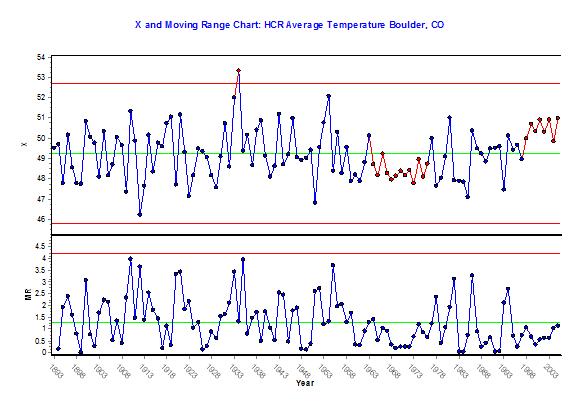

However, individual charts are notoriously poor at detecting small shifts in the average in a reasonable amount of time. If you are using ±3σ limits, even a massive shift of 3 standard deviations in the real mean has only a 50-percent chance of being detected on the first point. Also, the purpose of a control chart is to signal when there is sufficient evidence that the process has shifted, not really to determine if it is on target. You could, for our discussion, force the chart calculations to put the limits at a target. For our coating example, it would be the target thickness. For Boulder’s temperature, let’s use the average temperature from the beginning of the data set until 1900 (when my grandpa was born) or 49.00625. This way we can compare what I’m going to talk about later, and I won’t get accused of cheating.
Figure 2. X & MR Chart with μ = 49.00625
This doesn’t change our previous conclusions. (There was a new pattern of unexpectedly low variability around the mean, but because the mean was arbitrary, I don’t give it much credence.) This will allow us to compare it to the next chart we’re going to do.
If we take the average of the last run and compare it to the average of the rest of the data, I might actually get to tell my daughters that it was colder when I was a kid! By more than a Fahrenheit degree! With that run in there, I might even convince myself that it was colder, on average, when I was a kid than it was when my granddad purported to walk to school uphill.

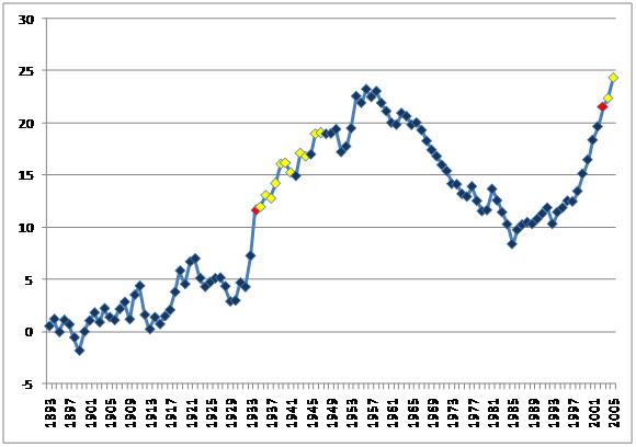

However, if our purpose is to detect even a subtle shift as early as we can, the control chart is not our tool of choice. For time series, we do have another choice, which is frequently neglected by Black Belts, but straightforward to use. It is the cumulative sum chart.
This chart (also called cusum) takes the cumulative difference off of the target for each point and adds them together. If the process is smack on target, the cusum will go up and down around zero. If the process is consistently off target, even by a tiny amount, that small difference in average will keep adding up. At some point, that difference will be enough to trigger a signal.
This is a very different chart than a control chart. If the average is a little off target, you will see an ongoing trend up. If the average comes back on target, the cusum will stabilize at that new sum (because the average added amount is zero), and if the process goes below average, you will see a trend down.
A cusum is a hypothesis test, so we need to choose an α (Type I error). A usual α is 0.05, though with cusums you can see α go much lower if the price of reacting is large compared to the price of missing a shift. We can choose a β (Type II error) as well, but it makes such a small difference for reasonable numbers it doesn’t even show up in the calculations. We also need to choose k, which relates to the magnitude of the shift we want to detect. This factor varies between 0.5 and 1.0, where the magnitude that is easily detected is 2kσ (though keep in mind that even a tiny bit off of target will eventually add up to a significant amount). Sigma here is our old friend the standard deviation. Because the data seem to be modeled adequately by the normal distribution, we can take the estimate of σ from the average moving range as a robust estimate of the process variation, or 1.383, so with a k = 0.5, we have a reasonable ability to detect a shift in average of about that same amount.
The last thing I need is a target temperature, so I chose the average temperature from 1893 to 1900 (you see now why I chose that average for the individuals chart). For a production process, it is easier as you choose your target or nominal.
Now in the old days, we would construct a v-mask and… but that’s complex. Instead, I will use the algorithm in Donald J. Wheeler’s Advanced Topics in Statistical Process Control (SPC Press, 2004), which I put into an Excel spreadsheet for my students.
Figure 3. Cusum chart, red points indicate a shift according to Wheeler’s algorithm, yellow points indicate the partial sums in excess of the critical value.
You will notice that there are no control limits. At the beginning, you can see the points bounce up and down around the target, which makes sense since we chose that average as the target. Starting in 1901, though, the cumulative sum doesn’t drop back below zero. Still, this might be due to chance, until the cumulative sum reaches a critical value. (We can’t use a run rule as in control charts, because the data aren’t independent. For example, one big spike could lead to a long run of cumulative sums above zero, even if the process immediately went back to target.) Using Wheeler’s algorithm, the point where the cumulative sum reaches significance is in 1934 (indicated by red). Now scroll back to the individuals chart and you can see that you never would have guessed that there was a warming trend confirmed in 1934 (there is only a spike there) and continuing to the early 1950s, and possibly starting as early as 1901, right after our average was taken.
Back to the cusum chart. Keep in mind what is going on here: each year that is below the target goes down from the previous point. Each year that is above the target goes up from the previous point. So, we see the overall warming trend (the slope is going up) but with some plateaus where the average was close to the target. The trend tops out in the 1960s and the cusum starts to slope down as the run of lower-than-target temperatures we saw in the individuals charts come into play. But after bottoming out in 1985, we see an increasing trend that becomes steep in 1996 and continues on up again due to that run above the mean that we saw in the individuals chart. Wheeler’s algorithm sends out a signal in 2003.
