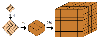

A company making hardwood flooring used the following procedure as its quality assurance plan. After fabricating six-by-six parquet tiles, the tiles were glued together into 12-by-12 squares and boxed 25 squares to a box (figure 1).
Figure 1: Pallets of parquet flooring

You are right; lots will have two levels of quality, with those of the originally rejected lots being 100% (if inspection is totally efficient), and accepted ones containing defects or nonconformances. The tile issue, of course, raises the additional issue of rolled throughput yield (RTY) in which, if four pieces must be put together, 95% quality becomes 81.5% quality.
