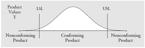

To simplify the mathematics, I will assume that the production process is being operated predictably, and that the stream of product values can be represented by our generic, worst-case probability model, the normal distribution. In our model we shall denote these product values by Y. In figure 1 we see the distribution of product values and the specifications for this product characteristic. This distribution represents the product stream, and when we measure an item, it is the value for Y that we are trying to determine.
Figure 1: The distribution of the product values Y
