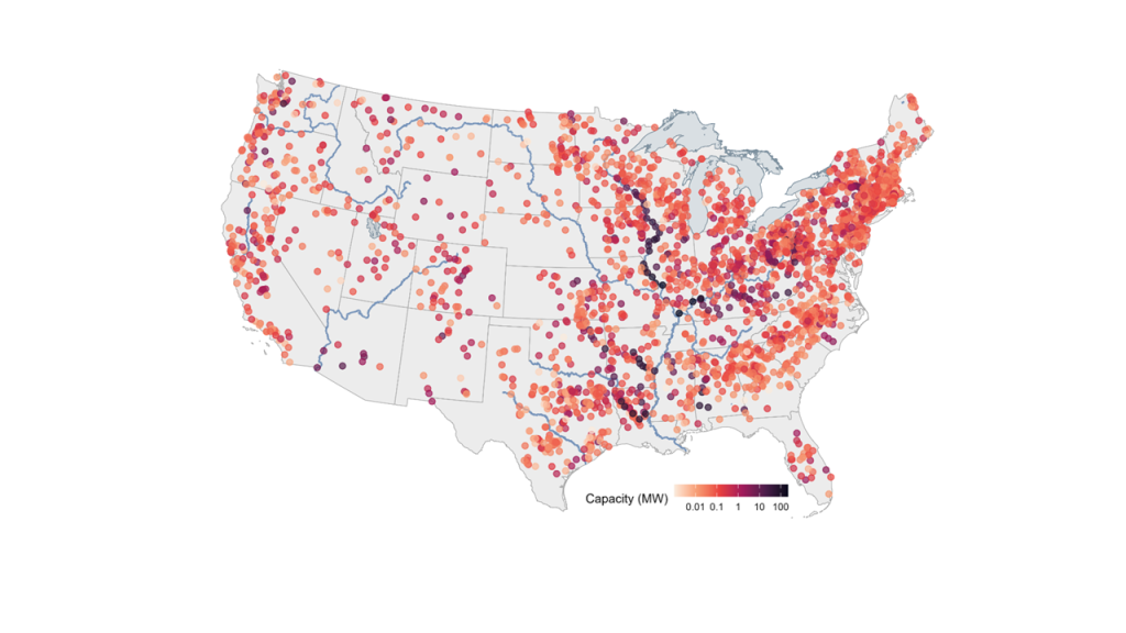

Analysis of the technical potential of these NPDs revealed that federally owned dams account for 86% of total capacity in the candidate sites. The assessment also pinpointed regions such as the upper Mississippi River and Great Lakes as particularly promising for hydropower development due to the large number of projects with high potential power capacity.

A map of technical potential for hydropower capacity at nonpowered U.S. dams. Credit: Oak Ridge National Laboratory, U.S. Department of Energy

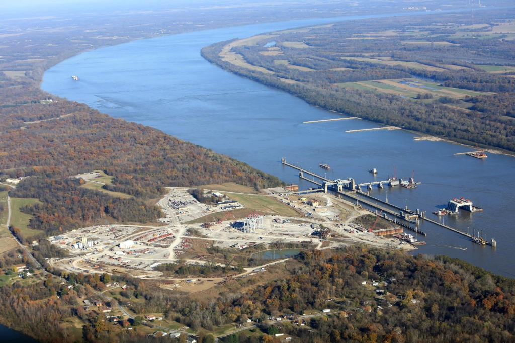

The Olmsted Locks and Dam in Illinois is a nonpowered dam identified as a candidate for hydropower generation in the NPD Hydro assessment. Credit: U.S. Army Corps of Engineers
