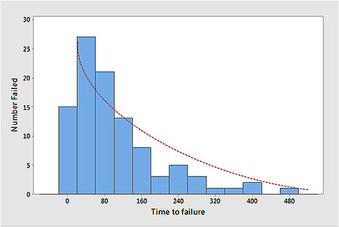

Suppose you track the time until failure of a randomly collected sample of items. When you graph the results on a histogram, you get something like this:
Notice that the number of items that fail at a given point in time decreases steadily as time elapses. This steady decrease can be fit nicely to an exponential curve.
