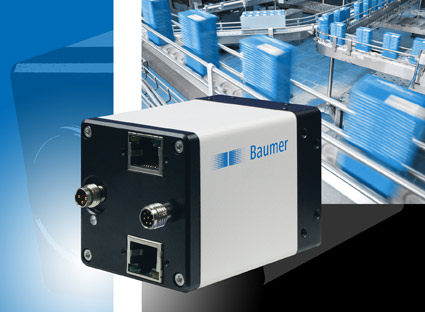

(Baumer: Southington, CT) -- For machine vision applications requiring high speed and high resolutions, Baumer has introduced its new SXG Dual GigE cameras that are capable of transferring data as fast as 240 MB/s at distances up to 100 meters. Offering double the bandwidth of standard GigE cameras, the Dual GigE’s simple interface features two Ethernet cables that improve security and ensure that data are maintained even if one Ethernet cable is disconnected.
SXG Dual GigE cameras are equipped with state-of-the-art Kodak sensors featuring Quad Tap readouts to simultaneously deliver excellent image quality and high frame rates. Image resolution for these cameras ranges from 1 to 8 megapixels and frame rates range from 16 to 120 frames per second.
All SXG Dual GigE cameras are available with Power over Ethernet (PoE) technology, eliminating a separate power cable.
