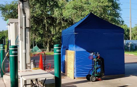

Figure 1: Typical setup for testing of CNG dispensers. The dispensed CNG is stored in the tank which is then weighed on a scale inside a tent to minimize the influence of wind.

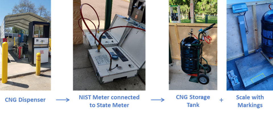

Figure : Typical CNG test setup including the NIST meter and (optional) State meter connected in a cascade fashion.
The Coriolis mass flow device is housed within the middle of the meter units and a pressure gauge on the right. Markings on the scale (highlighted) assures that the tank is placed in the same location during weighing.
