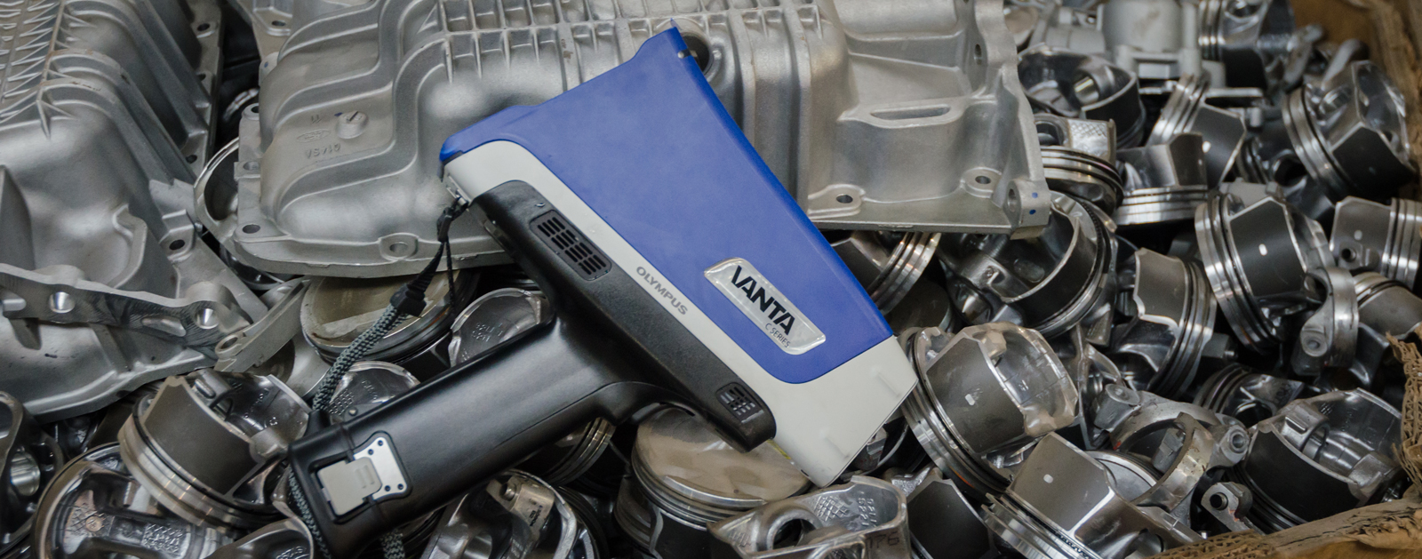

Handheld X-ray fluorescence (XRF) analyzers are proven analytical tools commonly used for the fast, easy, accurate, and nondestructive identification and analysis of metals and alloys. Common applications include metal alloy identification for quality control, scrap sorting and positive material identification (PMI), geochemistry for mining exploration and grade control, precious metal analysis, and hazardous elements screening for environmental, consumer goods, and restriction of hazardous substances (RoHS) testing.

For manufacturers in a wide variety of sectors, including aerospace, automotive, fabricated metals, and medical device, handheld XRF analyzers provide fast (less than 2 seconds for most alloys) verification of metal alloys such as:
