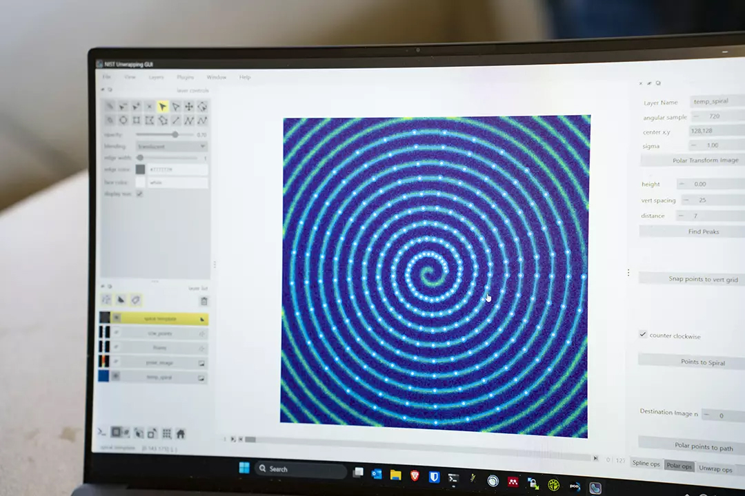

Four years ago, National Institute of Standards and Technology (NIST) researcher Cyrus Daugherty developed an algorithm to virtually unroll the tightly wrapped layers of a cylindrical lithium-ion battery. Daugherty’s software transformed X-ray images of the battery, taken at different angles, into a CT scan. The scan, a 3D portrait of the battery’s interior, pinpointed hard-to-spot defects and highlighted wear and tear on its electrodes.

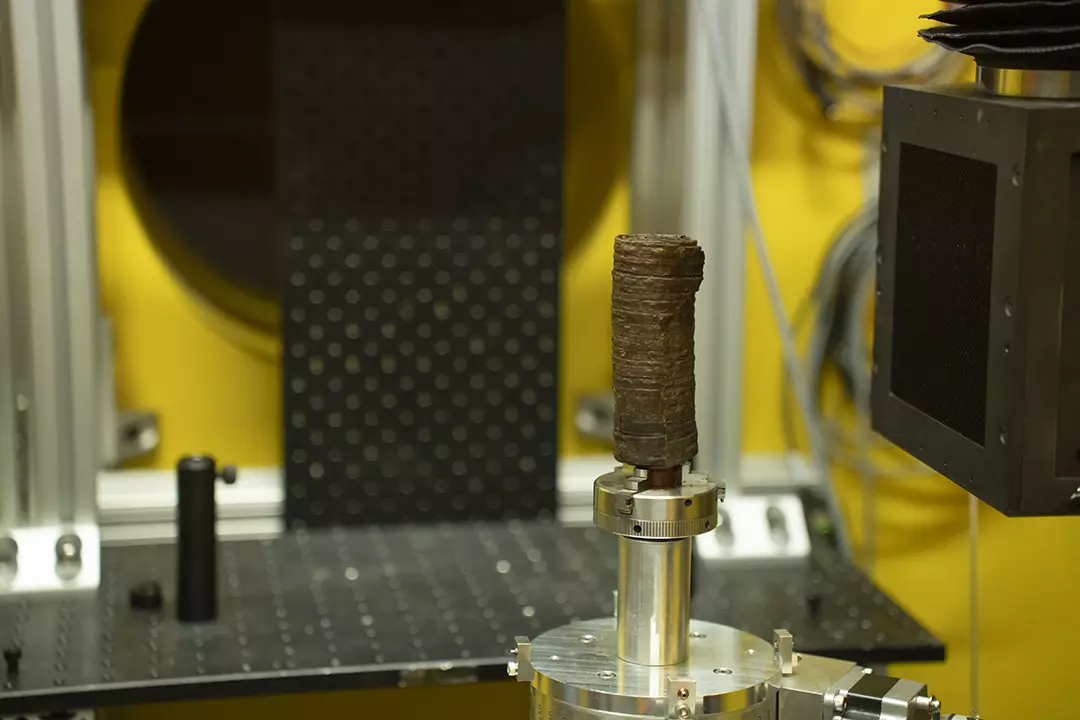

Seiler began designing replicas of the ancient scrolls a few years ago using modern Egyptian papyrus. To inscribe the scrolls, he dipped a stylus in carbon-based ink mixed with varying concentrations of lead sulfate. Those mixtures, experts believe, have a composition similar to the ink used in Roman times.
Seiler, along with David Kreimer at the University of California-Berkeley, wanted to mimic the harsh conditions to which the Herculaneum scrolls were subjected. To do so, they placed each replica scroll in a separate, partially sealed steel container. Then they inserted the containers in a high-temperature furnace with little or no oxygen.

Modifying the software wasn’t easy. The layers of a lithium-ion battery are evenly spaced and form a perfect spiral as they wrap around the battery’s core. In contrast, the carbonized papyrus scroll is squashed, with some layers fused.
Attempting to unwind the scroll by treating its wrapped layers as a perfect spiral would result in an unreadable image. It would mix text from different layers, along with large blank spots.
Nonetheless, in about a week, Daugherty modified his software so that it could examine Seiler’s replicas.
A CT scan of a replica of an ancient papyrus scroll carbonized by the eruption of Mount Vesuvius reveals the tightly wound layers. Credit: Megan King/NIST
The NIST study had one major advantage over the effort to decipher the ancient scrolls retrieved from Herculaneum. The inscriptions on the replicas were known. Seiler had written them himself but intentionally did not disclose the text to the NIST scientists.
That meant Daugherty’s software could be tested against ground truth. The more accurately the software deciphered the text on the replica scrolls, the more confident the team could be that the software accurately deciphered the text on the ancient scrolls. Daugherty’s algorithm successfully deciphered the text in a matter of days.

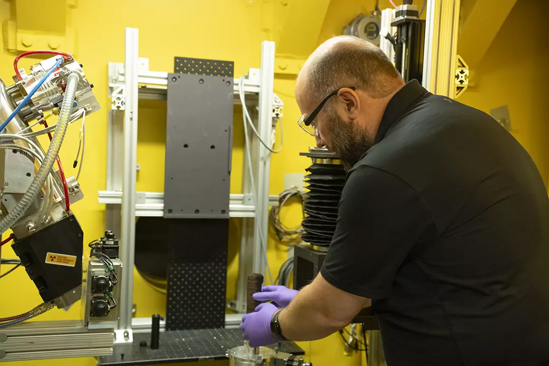

The NIST team made one other contribution, which they report in the Sept. 16, 2026, issue of PLOS One. Because lead interacts much more strongly with X-rays than does carbon, LaManna surmised that any of the ancient scrolls inscribed with an ink containing lead salts should be easier to read. That prompted LaManna to wonder: Could he find a rapid, inexpensive, and nondestructive way to identify the Herculaneum scrolls written with lead ink?
LaManna found that a common laboratory device, an X-ray spectrometer, met his criteria. The spectrometer shoots X-rays at a material under study. The spectrometer’s X-rays cause every element in the sample to emit its own X-rays in a different, unique pattern. These “fingerprints” enable researchers to rapidly and inexpensively identify elements, including lead, in the material.
