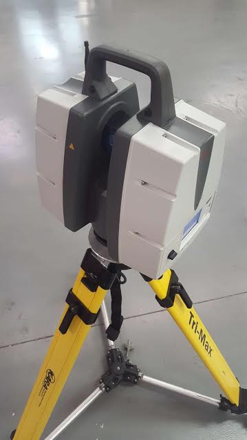

While wearing full radiation-protection suits, Exact Metrology personnel scanned piping in more than two dozen rooms throughout the power plant, using Leica HDS scanners. The Leica scanners were capable of capturing full-volume, 360-degree, 3D point clouds in about three minutes. Some rooms required only a single setup, which resulted in minimal exposure times to the harsh nuclear environment. Once a scan is initiated, the data acquisition is completely automated, allowing the metrologist to retreat to low-dose areas while critical data continue to be captured by the device.
Once scanning was completed, the multiple scan setups were stitched together to form one large point cloud. This allowed users to extract data from any section of the pipe run, from any perspective. Complex software algorithms then provided a function to extract all pipe sizes, centerline, and position, even when only part of the pipes were scanned. As an added benefit, the dense point cloud obtained revealed areas of crystallization, which indicated that leaks in the pipes were already in progress.
The advantages of using 3D scanning vs. the traditional tape measure and ladder of the past, were numerous. The elimination of human error, greater accuracy, and speed were the obvious upsides. Operator safety, especially in high radiation and contamination areas, was greatly increased due to the speed and operational characteristics of the scanners, which allowed operators to spend minimal time in dangerous rooms. The scanners allowed operators to take measurements from the ground, avoiding the danger associated with ladders, scaffolding, and harnesses. Scanning from ground level also avoided the need for the permits that would have been required to climb ladders above a certain level; for fall protection; for air monitoring in higher elevations; and for contact with possible contaminated surfaces.
