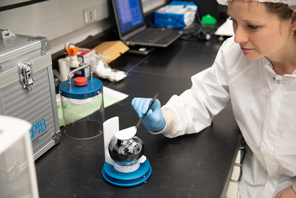

While the kilogram is still the official international unit of mass, NIST has been revisiting how to measure the gram with precise mass-measurement devices called tabletop Kibble balances. Improving our ability to measure the gram is useful for pharmaceutical manufacturers, that want to dispense drug doses accurately, and for the military and companies that need to make precision parts for electronics, aerospace, and other critical applications.
German researcher Beatrice Rodiek prepares “the sphere”—one of the roundest objects on Earth—to be measured on a highly accurate weighing machine, known as the Kibble balance, at NIST’s campus in Gaithersburg, Maryland. Credit: B. Hayes/NIST
