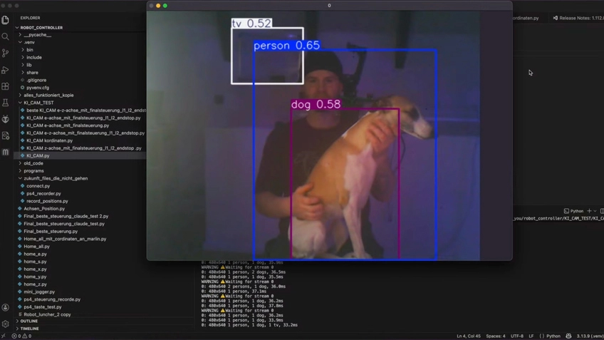

For recording, he chose the Sony QX10. Though reasonably low-quality by today’s standards, its 130 g compact form factor made it ideal. To track his movements, Leon also equipped a USB camera plugged into a Mac Mini. Using You Only Look Once (YOLO) software, the device could be trained to focus on the YouTuber in any given frame.
A YOLO software screenshot showing Leon being tracked by AI. Image courtesy of WhippetInTech

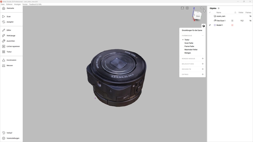

Once all this was in place, all that was required was a custom camera mount. This is where Artec Studio came into play, turning a few photos of the Sony QX10 into an ultrarealistic 3D model that could be used as a reference for designing a fixture in CAD software.
“I had seen a promotional video showing that Artec Studio could now generate 3D models from ordinary photographs,” Leon says. “That made me want to try the feature for myself. I have to admit that I was genuinely surprised by the result. With an object of this size, I had previously only achieved comparable results with Artec Eva after considerably more work.”
CAD design with photogrammetry data
When using handheld 3D scanning, Leon normally has to align, filter, register, and fill holes in Artec Studio to create a complete, watertight 3D model. The AI Photogrammetry workflow is much more straightforward, with the software automating many traditionally manual steps.

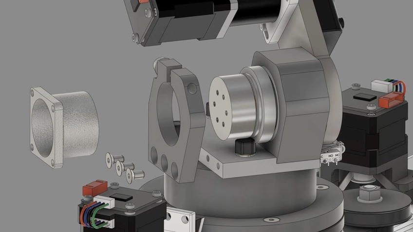

After hole-filling and removing the surface underneath the camera, he was ready to use it as a basis for design in PTC Creo. With this advanced software, the photogrammetry model could be scaled to its actual size and turned into solid CAD geometry. This can be done by hand, but it’s extremely difficult with organic shapes. Mesh data make the process much more precise.
WhippetInTech’s enhanced robotic arm shoulder joint. Image courtesy of WhippetInTech
Once ready, this solid camera model was dropped into a CAD assembly of the robotic arm so a custom housing could be built around the existing setup. To give the robot a futuristic look, the resulting mount was 3D-printed in resin from translucent material. Attached alongside a red LED and Wi-Fi antenna, this made the device look like HAL 9000 from 2001: A Space Odyssey.
