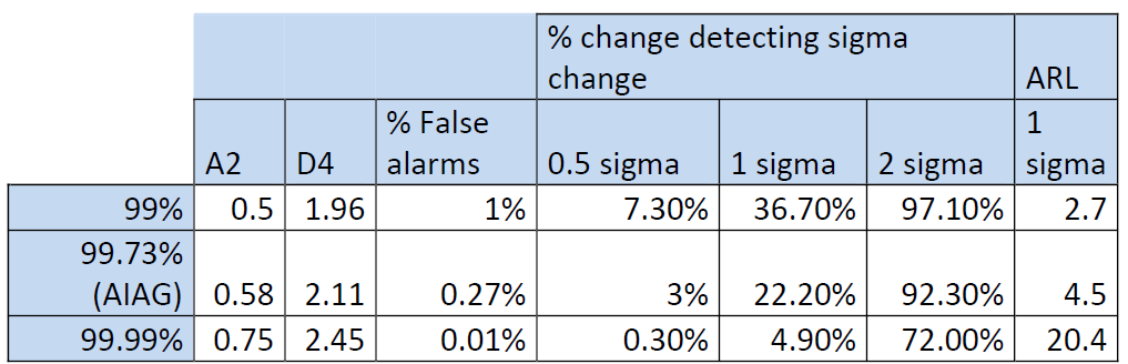

Comparing different confidence levels
To illustrate these trade-offs, Figure 1 compares three commonly discussed confidence levels for an XR chart with a subgroup size of five.
Figure 1: Results for different confidence levels based on an XR chart with n = 5
Several observations can immediately be made.
A confidence level of 99% substantially increases the probability of detecting small process shifts. However, this comes with a corresponding increase in false alarms.
At the opposite extreme, a confidence level of 99.99% dramatically reduces false alarms but significantly decreases the chart’s ability to detect meaningful process changes in a timely manner.
The traditional 99.73% confidence level remains a well-balanced compromise between these two extremes.
Interestingly, the examples provided in the new VDA AIAG SPC Manual focus primarily on confidence levels of 99% and 99.73%, suggesting that the authors expect users to consider somewhat tighter limits where appropriate rather than universally widening control limits.
Changing the confidence level is not a way to improve process capability. It only changes how sensitive the control chart is to process variation. A wider control limit reduces false alarms but also delays the detection of genuine process changes. Manufacturers should therefore select confidence levels based on operational requirements rather than expecting improved process performance.
