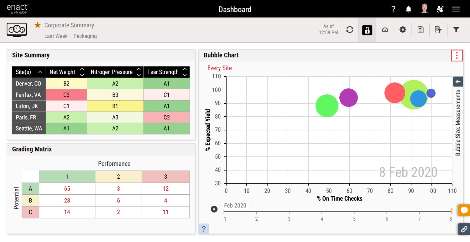

A good QI system provides much-improved visibility into data—which can reveal inconsistencies between runs and production lines as well as quality issues that have been invisible with paper-based data sets. Here’s an example of a dashboard we might use to start our investigation.
Use a grading matrix, like that provided with Enact, to identify all data streams flagged as “A3,” which means the short-term standard deviation indicates 100-percent yield is possible, but the process isn’t performing that well.

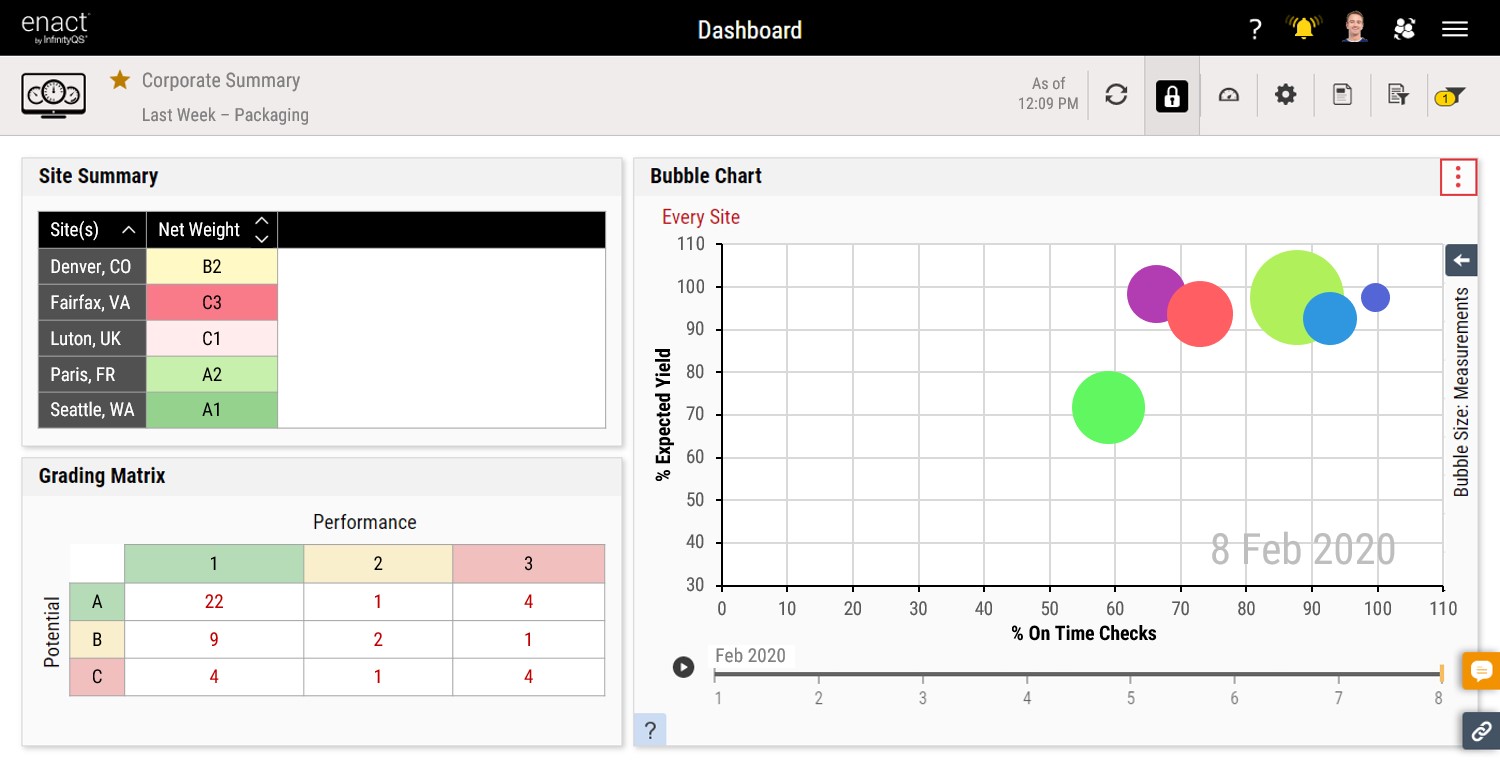

Since we are focusing only on net weight, it makes sense to filter the dashboard to show only net weight results. The example below now shows there are four data streams with a grade of A3, which will be the starting point for further analysis.

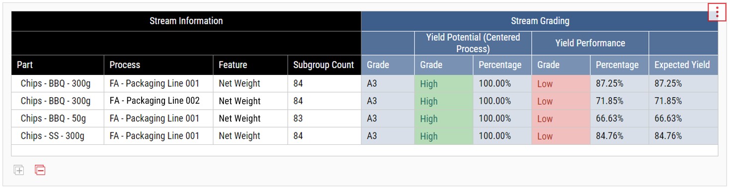

A simple click on the “A3” cell provides the details of which products and which production lines are performing this way.
At this point, it is clear to see that the site in Fairfax, Virginia (denoted by the “FA” in the process name), has several opportunities for easy wins . We can now contact the Fairfax site to discuss how it can improve its yield. With a process potential of 100 percent, this is hopefully a simple solution like retargeting the process (or more likely, just leaving the process alone instead of making changes for each run or shift).

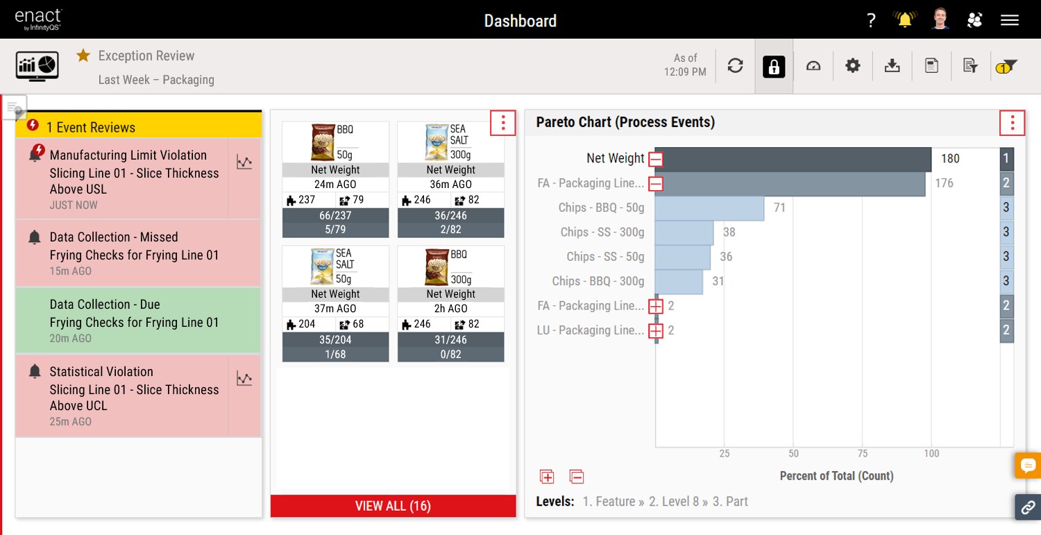

Because everyone is using the same QI system, the same data can be used to investigate these exceptions at a more granular level. This dashboard below is focused on exceptions, though traditional tools like Pareto and box-and-whisker charts are also commonly used. The stream summary tile shows that the “BBQ—50g” chips have the most issues with net weight (the images are ordered by number of issues). It is a simple click on that icon to look at the associated control chart.

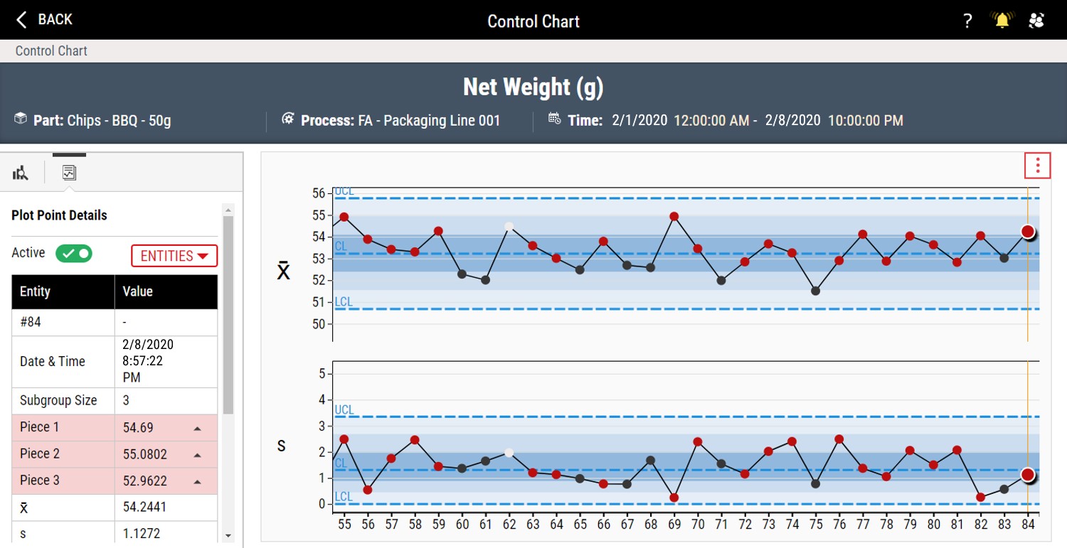

Viewing the control chart confirms that the process is running consistently but is consistently overfilling product. There are many upper-specification-limit violations, and this behavior warrants a discussion with the operators on why the process is performing this way.
Perhaps there’s a setup issue that needs to be addressed. Maybe there’s a new filler on the line, and it hasn’t been fully calibrated. It might also be as simple as the operators aren’t looking at their notifications. There are other tools that can be employed to help. For example, each time a specification limit violation is encountered, the user could be required to enter a comment, or better yet, select a corrective action they took to address the violation. These can then be analyzed to see if a cause can be found. Another user for your QI system is to see how other sites perform when making the same product. Perhaps they have experienced this same issue and have a solution.
