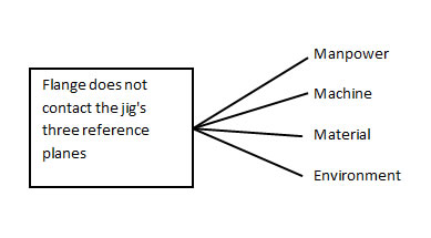

Figure 2: Failure mode in a cause-and-effect diagramFunction analysis
• Failure effect = What happens that should not happen, or what doesn’t happen that should
• Failure mode = How the failure effect occurs
• Failure cause = Why the failure mode occurs (which is incidentally an open invitation to apply the 5 Whys to each potential failure cause)

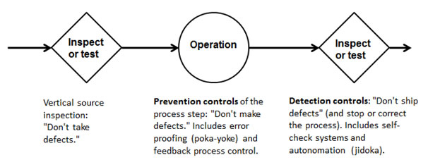

Figure 3: Successive checks for a process stepRisk analysis

• The occurrence root cause is why the problem happened, which suggests inadequate prevention controls. The occurrence root cause also relates to “don’t make it” with “it” meaning poor quality. If the corrective action is to apply a new or better prevention control, the PFMEA should be updated accordingly.
• The escape root cause is why the nonconformance reached the next internal or external customer (if it did), which relates to the detection controls, as in “don’t pass it along.” Corrective action for the escape root cause is likely to involve a new or better detection control, for which the PFMEA also requires modification.
