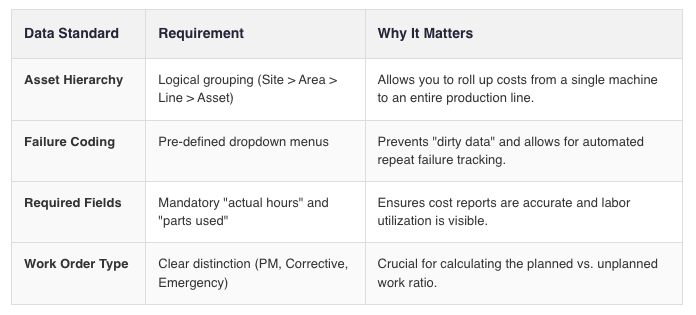

The data standards behind reliable reporting
You can’t build a skyscraper on a swamp. To get reliable maintenance analytics, you must standardize how data enter your system. Here’s a step-by-step format for implementing data standards.
Audit your current failure codes: Remove vague options like “other” or “repair.”
Configure your CMMS: Set mandatory fields so a work order can’t be closed without specific data points.
Train the front line: Explain to technicians why these data matter. If they know the data help justify new tools or better parts, they’re more likely to provide accurate entries.
Review weekly: Spend 10 minutes a week reviewing new work orders for data quality.
