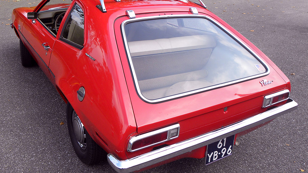

Making its debut in 1970, the Pinto was Ford Motor Co.’s first subcompact. In 1978, Ford was compelled to recall the car due to its propensity to burst into flame when struck from behind.

3. During the late 1970s, Ford Motor Co. cut corners in manufacturing the Pinto, a subcompact which had a fuel tank that sometimes exploded in rear-end collisions. MotorTrend reports that the company had to pay out millions of dollars (in 1970s dollars) for the resulting deaths and injuries, and even faced a criminal indictment for reckless homicide (of which it was acquitted).
