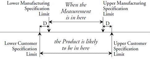

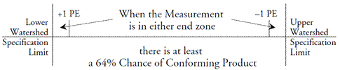

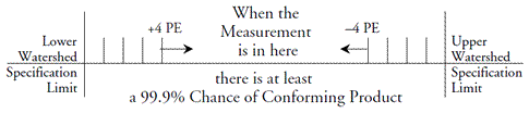

During the past 20 years it has become fashionable to condemn measurement processes that are less than perfect. Yet the reality is that we must always use imperfect data. Given this fact of life, how can we ever know if a measured item is or is not within the specifications? Put another way, how can we make allowance for measurement error when characterizing product relative to specifications?
To complicate the answer to these questions, we have measurements that have measurement units attached, and we have the uncertainty in those measurements that are expressed in terms of measurement units squared. Much of what has been written about these problems has been flawed. However, rigorous treatments of these issues are available, and in this article I shall present the results of them.
The uncertainty in a measurement
The uncertainty in any measurement may be defined by the standard deviation of repeated measurements of the same item. In practice this quantity may be estimated by having one operator measure a set of items two or three times each, using the same instrument, as follows:
