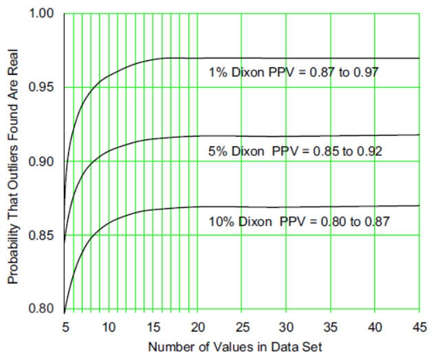

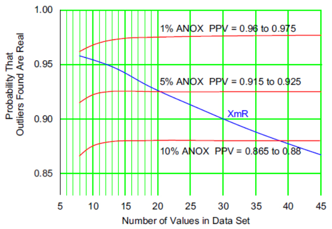

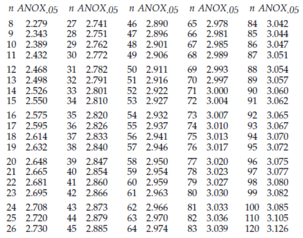

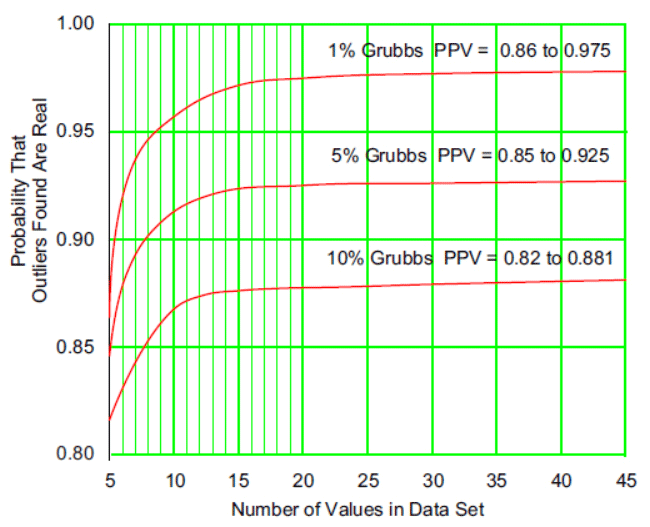

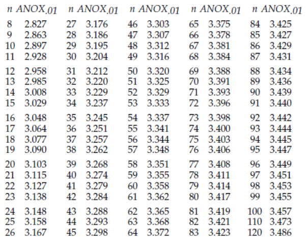

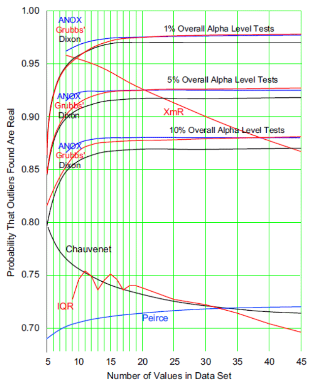

In part one we found the baseline portion of an XmR chart to be the best technique for identifying potential outliers among four tests with variable overall alpha levels. In this part we will look at tests which maintain a fixed overall alpha level regardless of how many values are being examined for outliers.
