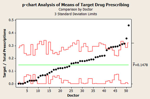

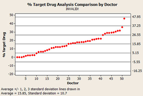

My last article demonstrated a common incorrect technique—based in “traditional” statistics—for comparing performances based on percentage rates. This article will use the same data to show what should be done instead.
To quickly review the scenario: In an effort to reduce unnecessary expensive prescriptions, a pharmacy administrator developed a proposal to monitor and compare individual physicians’ tendencies to prescribe the most expensive drug within a class. Data were obtained for a peer group of 51 physicians including the total number of prescriptions written, and, of that number, how many were for the target drug.

Another excellent article.  Two questions:
1)  I don't have or need the raw data, but because I don't have that, I can not figure out what entry is used in the ANOM for # of prescriptions written.  I would think it would be the number of individual prescriptions for the targeted drug an individual doctor has written, rather than the bulk # of prescriptions written (4000+) or the bulk # of prescriptions for the drug in question (596).  Can you enlighten me?
2)  Where does the formula for the ANOM come from?
Regards and thanks again,
Tom Johnson
