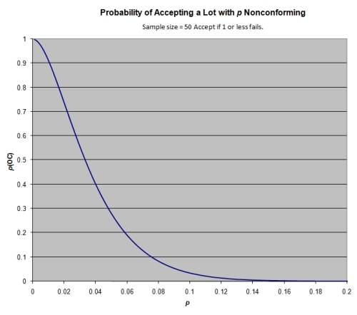

You can kind of see the original purpose of acceptance plans. If we assume that defective product is inevitable, then we had better figure out a way for making sure we don’t get too many defective products. To this end, the creators of MIL-STD-105 (and its descendants, e.g., ANSI/ASQ Z1.4) used the concept of inferential statistics (based on the binomial distribution) to create a sampling scheme that could be used by a customer to determine if they should accept a shipment from a supplier. They constructed a series of tables and rules that would allow you to determine how large a sample to take, and the number of “bad” samples allowed before you would reject the shipment.
