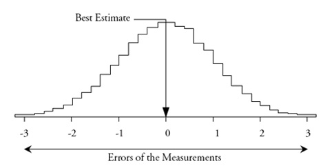

If we repeatedly measured the same thing thousands of times using the same measurement system, and if our measurements had very small increments, we would end up with a histogram of measurements like figure 1. Given such a collection of measurements, the intuitive estimate for the value of the thing being measured is the average of all of the measurements. But what does the dispersion of the histogram in figure 1 represent?
Figure 1: Repeated measurements of the same thing
