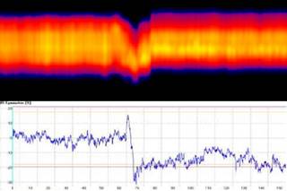

Figure 1: Detect off-seam weld
Now available, the thermal profile system provides real-time, in-process, at-the-weld monitoring as well as welding inspection and detection of welding defects. The system utilizes the thermal distribution of the heat-affected zone to detect irregularities of the thermal field during solidification of the welded seam (figure 1).
