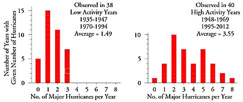

A few years ago a correspondent sent me the data for the number of major North Atlantic hurricanes for a 65-year period. (Major hurricanes are those that make it up to category 3 or larger.) I have updated this data set to include the number of major hurricanes through 2012. The counts of these major hurricanes are shown in a histogram in figure 1.
Figure 1: Histogram for the number of major North Atlantic hurricanes 1935–2012

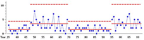

An excellent, practical article.  And once again, the run chart comes through.  Thank you.

It's continues to puzzle me why data analyists/quality engineers don't start with plotting the data in time order. You would think this would be the first logical step. So very easy to do and so much to be gained. It appears advances in statistical software has made it so easy to do dumb things.
