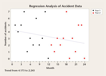

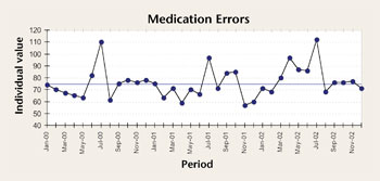

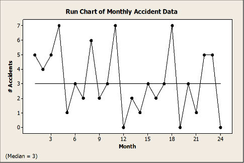

In my last column, I showed how hidden special causes can sometimes create the appearance of common cause, but the purpose of common-cause strategies is to deal with this and smoke them out. When there's an underlying structure to how these data were collected, or when one can somehow code each individual data point with a trace to a process input, stratifying the data accordingly can many times expose these special causes.
Even the simple coding of individual points on a graph can be every bit as effective as the more formal tool of a stratified histogram. I’m going to take the issue of understanding variation in count data further in the next couple of columns. I’ll begin here by looking at two scenarios.

Excellent article, Davis, and good examples, as usual. The hairs on the back of my neck always stand up when someone in a meeting presents a chart of data with a "trend line". Unfortunately, the software companies have made it far too easy to add a so-called "trend line" line that has no meaning to a mass of data. People love to add a trend line, no matter how slight, to support whatever premise they are trying to prove. "Oh, look! We're trending in the right direction." I usually ask for the raw data and 99% of the time, find that a scatter plot with 95% confidence limits for the least squares fit line clearly shows that the "trend" is not significant. Pass the barf bag, please. I have learned to hold my tongue in meetings (If you know me, you know that ain't easy for me!) and instead have private discussions with the perpetrator of "bad statistics", even though the damage is already done. The downside is that this usually means more work for me! OK..."Teach a man to fish and he will"...continue to ask you to analyze his/her data for him/her. Run charts as very easy to plot and analyze. We MUST find a way to use them and, in most situations, be able to ban the phrase "trend line" from presentations. Time-ordered data is precious and should be properly analyzed.
