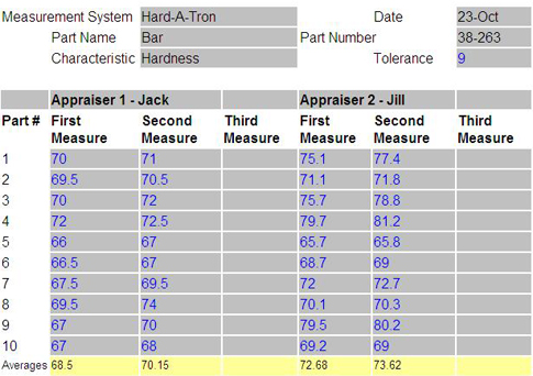

If you can’t trust your measurement system, you can’t do anything with the data it generates. Last month, in “ Letting You In On a Little Secret,” we talked about the purpose of measurement system analysis (MSA) and I gave you a neat spreadsheet that will do MSA for you, as well as some data (repeated after the jump) from the gauge you want to buy, the Hard-A-Tron. I also left you with a mysterious statement that this study was trickier than it appeared. This month I’ll start off answering a question I received, and then we will see how well the Hard-A-Tron did—and what mysterious thing was going on in the data. After that, if you are good, I’ll give you another set of data to further test a measurement device.
