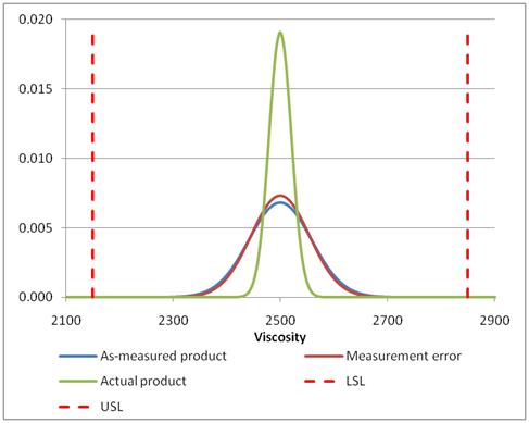

So I thought I was done with measurement system analysis after my last column, but I just finished reading Don Wheeler’s June 1 column, “Is the Part in Spec?” and the first thing I thought was, “Well, that was… complicated and ultimately unhelpful in answering the article’s title question.” I like a diversity of viewpoints, but they have to make sense. Does Wheeler’s? Let’s take a closer look.

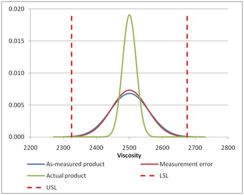

As far as guardbands, I have no quarrel with these at all, as long as you understand the costs. We too have had to do similar things over the years, but my point is that you have to make such decisions with an understanding of the process as well as the costs involved.
For the example with crash sensors, if you had a control chart on this product characteristic and it showed that you were in control, you probably never made an accelerometer anywhere near a spec limit in your life, and every single one you scrapped was not just, perfectly OK, but darn near the target. On the other hand, if your control chart was out of control (as it sounds like from your description) - long-term you should have been working to attain control so that you didn't have the anxiety of knowing that measurement error could be allowing bad stuff to ship, at the potential cost of someone's life. Short-term you might use temporary rejection limits to make up for your lack of control.
It all has to do with decomposing the sources of variation (as I did in those graphs above). Which I bet was involved in your ANOVA-based approach. ;-)
That said, in some cases (e.g. aerospace, auto safety) due to non-mathematical considerations (and nothing is ever just a cost-benefit analysis), you might very well have crazy rejection limits. I am only saying you had better understand those costs and build them into the price.

You might be right - that is Dr. Wheeler's position as to what the article is about. But I just don't see it, and I spent weeks looking at it and had multiple people read it, and they all concluded that he was saying to tighten rejection limits in response to high gauge variability in order to ship conforming product. So at least a few of us are reading it that way, and I thought it valuable to point out the fallacy of that approach.
But note: if that thing you measure at 6.1 comes from a process that is in control with a Cpk > 1, it is almost certainly in spec. If that 6.1 is taken without any process context, sure, it might be out of spec or in spec. My article is trying to get you to look at that extra context in order to make informed conformance decisions.

My position is that Wheeler's article does not convey to those reading that article alone without the context of other materials what the correct actions should be. So this is partly an issue about communication, partly a difference of approach. I know Wheeler knows this stuff, but you can't judge the impact of an article on what you think the author meant, you must judge it on what is in the article. The problem is that the article tells the reader that in order to ship high conformance stuff, you must tighten the manufacturing specs, and this is simply not true. Or rather, it is only true in narrow circumstances and is not true across the board. And we are not talking about a "little" scrap and re-work...in the example above, we know that it will be around 30% scrapped and reworked that are in fact really close to target and far away from spec limits. I call that unnecessary waste.
Had the article been an article about the very narrow question "how to determine if a part is in spec regardless of process understanding and in the presence of known gauge error" then the article would have been a lot shorter and would have mentioned the caveats that are applicable. But when multiple people read it and conclude that it is an article about a process used to ship conforming product (which I contend is a possible reading), we have a problem.
As you say, in the few circumstances where this applies, this should be a temporary (and expensive) holding action. You and I and maybe Wheeler know this, and yet the concept is not in the article.
As you say, it is only relevant in the situation where you have high gauge variability and a process that is either out of control or with a Cpk < 1 (or possibly high-risk as other comments present). You and I and maybe Wheeler know this, but it too is not in the article.
I read Wheeler's article and thought, "Oh my goodness, people are going to read that and think they need to decrease internal rejection specs in order to get conformance." I base this reaction on specific sentences that say exactly that. And this interpretation drives incorrect (and unnecessarily expensive) behavior.
I fully concede that I may be interpreting the article incorrectly, but if so I am not the only one and I think it is valuable to point out how this interpretation could be devastating.

It makes more sense to me to use that approach, at most, as a stopgap. If I am in a high-risk industry, why should I tolerate high gauge variation as a proportion of spec?
