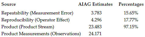

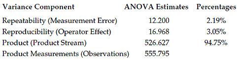

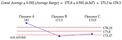

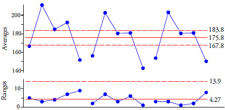

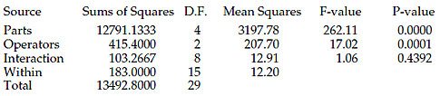

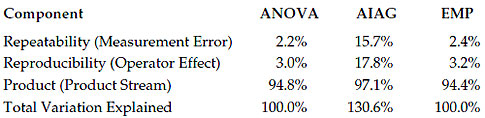

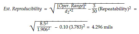

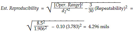

It would appear that there is still considerable confusion regarding which method to use in evaluating a measurement process. There are many voices speaking on this subject, however, most of them fail to use the guidance provided by statistical theory, and as a result, they end up in a train wreck of confusion and uncertainty. Here the three most common methods will be compared side by side.
Our example will use the data obtained from a gauge used to measure gasket thicknesses in mils. Three operators measure five parts two times each to obtain 30 measurements arranged into 15 subgroups of size 2 as shown in figure 1. To understand these data it is helpful to observe that the operator-to-operator differences show up between the subgroups, the part-to-part differences show up between the subgroups, and the test-retest error shows up within the subgroups. This organization is the key to interpreting these data.
Figure 1: The gasket thickness data. Click here for larger image.
