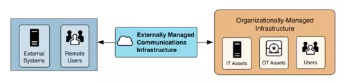

NIST defines remote access as “access to organizational systems (or processes acting on behalf of users) that communicate through external networks.” An example is shown in the figure below. This access can be user-initiated access by an employee, vendor, contractor, consultant, or an automated external system that’s authorized to perform work or monitor conditions without being physically present onsite. In OT environments, remote access enables the user to interact directly with the controls of the physical systems for support, troubleshooting, diagnostics, and management.
Credit: NIST
However, not all remote access is inherently secure. The practice of securing remote access involves many factors, typically by implementing security controls. Security controls are usually deployed in a layered approach and include combinations of technical and administrative solutions. Examples of technical controls include: encryption of data and network traffic; multifactor authentication (MFA) to validate user identity; segmentation to separate OT networks from the enterprise ecosystem; specialized jump or bastion servers to manage network traffic reaching OT assets; and network visibility tools that provide logging and monitoring of access. Examples of administrative controls include: establishing access control lists to limit which users can reach an asset; enforcing least privilege to minimize permissions; reviewing logs for accountability; and establishing supporting governance policies.
