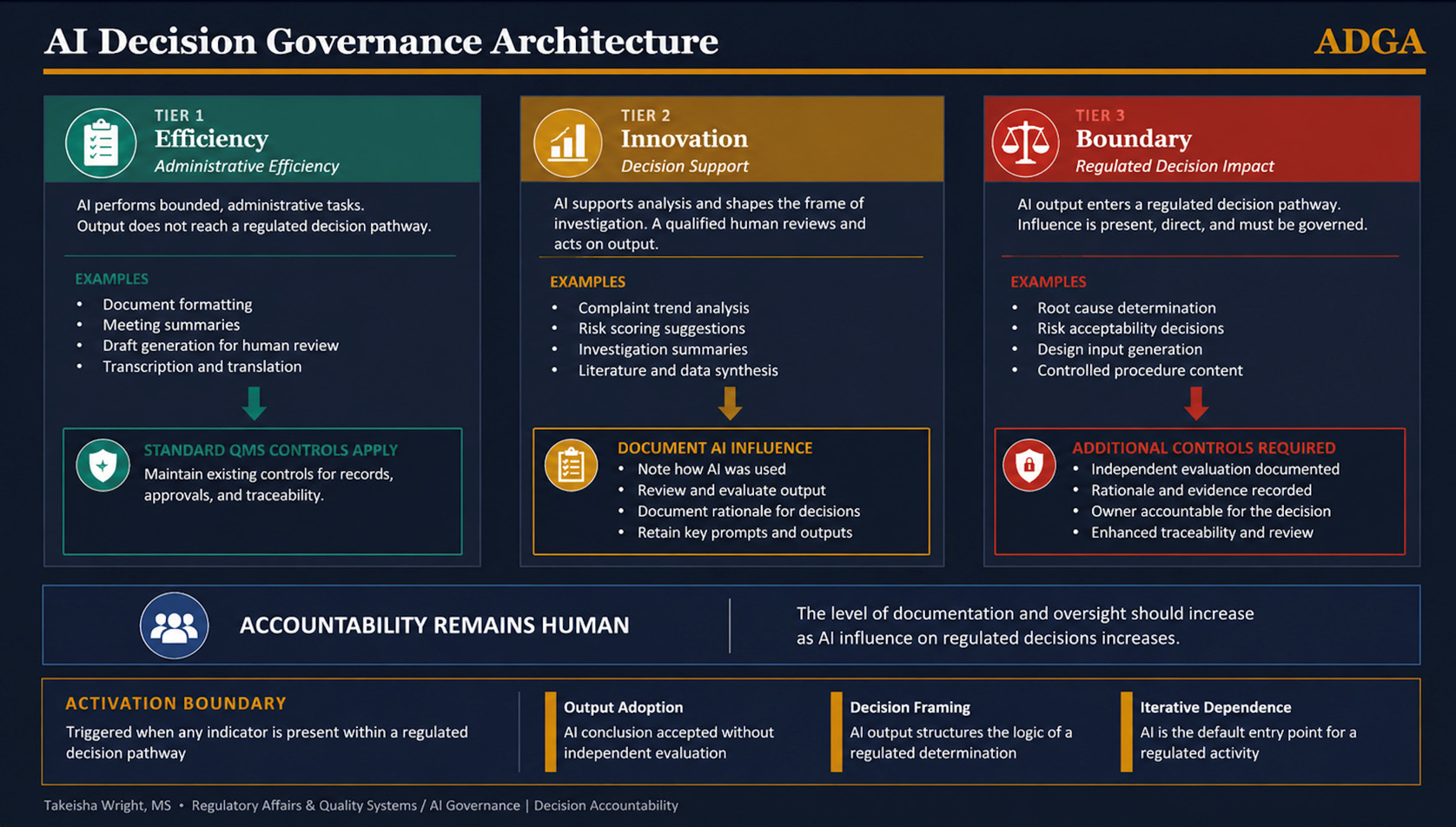

AI influence on regulated decisions
I don't disagree that organizations often get more value from proactive process monitoring and SPC than from retrospective CAPA investigations. In mature quality systems, the goal should be to identify process shifts before they become nonconformances.
However, that is a different question from the one I was trying to address in the article.
Whether the activity is a CAPA investigation, risk assessment, change evaluation, document review, or process monitoring exercise, organizations are increasingly using AI to summarize information, identify patterns, suggest causes, prioritize risks, and recommend actions. The governance challenge is not whether AI should be used. It already is.
The question is what happens when AI begins influencing conclusions in regulated processes.
I actually agree with your concern that AI could turn CAPA into an even greater box-checking exercise if teams simply accept AI-generated root causes without critical evaluation. That is precisely why documentation of human review, rationale, and decision accountability becomes more important, not less.
The article is not arguing against AI adoption. It's arguing that efficiency gains do not eliminate the need to understand and document how conclusions were reached. If an investigator, auditor, or regulator asks why a particular root cause, risk rating, or corrective action was selected, the organization still needs to be able to reconstruct that reasoning.
