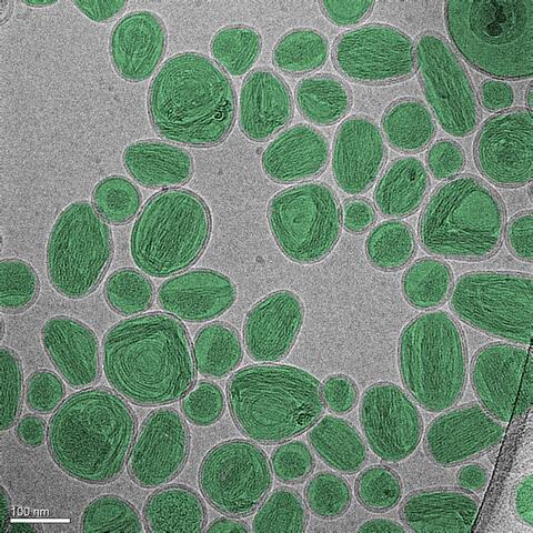

A colorized electron microscope image shows lipid nanoparticles containing a cancer drug. The amount of drug contained depends on the size of each nanoparticle. NIST researchers have developed a new analysis to better understand how the useful properties of nanoparticles depend on their size—in this example, to optimize drug delivery to cancer patients. The new analysis can also find use in other products that use nanoparticles and other nanomaterials, including electronics, ceramics, and coatings. Credit: Dr. Pierre-Alain Burnouf/Shutterstock, Natasha Hanacek/NIST
