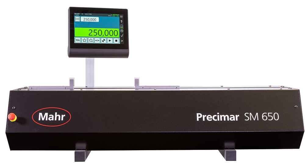

(Mahr: Providence, RI) -- Mahr, a leading provider of dimensional metrology solutions, introduces the new Precimar SM setting instrument, designed to simplify and accelerate the adjustment of measuring equipment. By automating the process, the Precimar SM eliminates the complexity of manual calibration with gauge block combinations and expensive setting rings, resulting in significant time and cost savings.
Enter the desired reference value and the Precimar SM automatically positions itself as a setting standard with the relevant dimensions.
With an exceptional accuracy of 0.7 μm + L/1,000, the device is an ideal solution for calibrating measuring equipment such as indicating snap gauges, universal measuring instruments, and two-point inside measuring devices. Designed for production environments and available in measuring ranges of 350 mm, 650 mm, and 1,150 mm, the Precimar SM is compatible with a variety of accessories for mounting different types of measuring devices. Its intuitive touch display provides straightforward operation featuring a wide range of functions, including favorite settings for quick adjustments and barcode scanning for effortless dimension selection.
