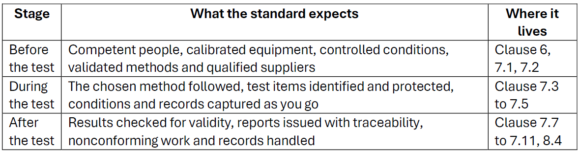

The standard groups its requirements into resources, the testing process, and the management system that holds them together. You can plan for all three at once by anchoring them to the thing that your lab actually produces: a test result. Each result has a before, a during, and an after, and ISO 17025 has something to say about each. Plan around that, and accreditation tends to look after itself. Here is the same picture, mapped to the standard.
