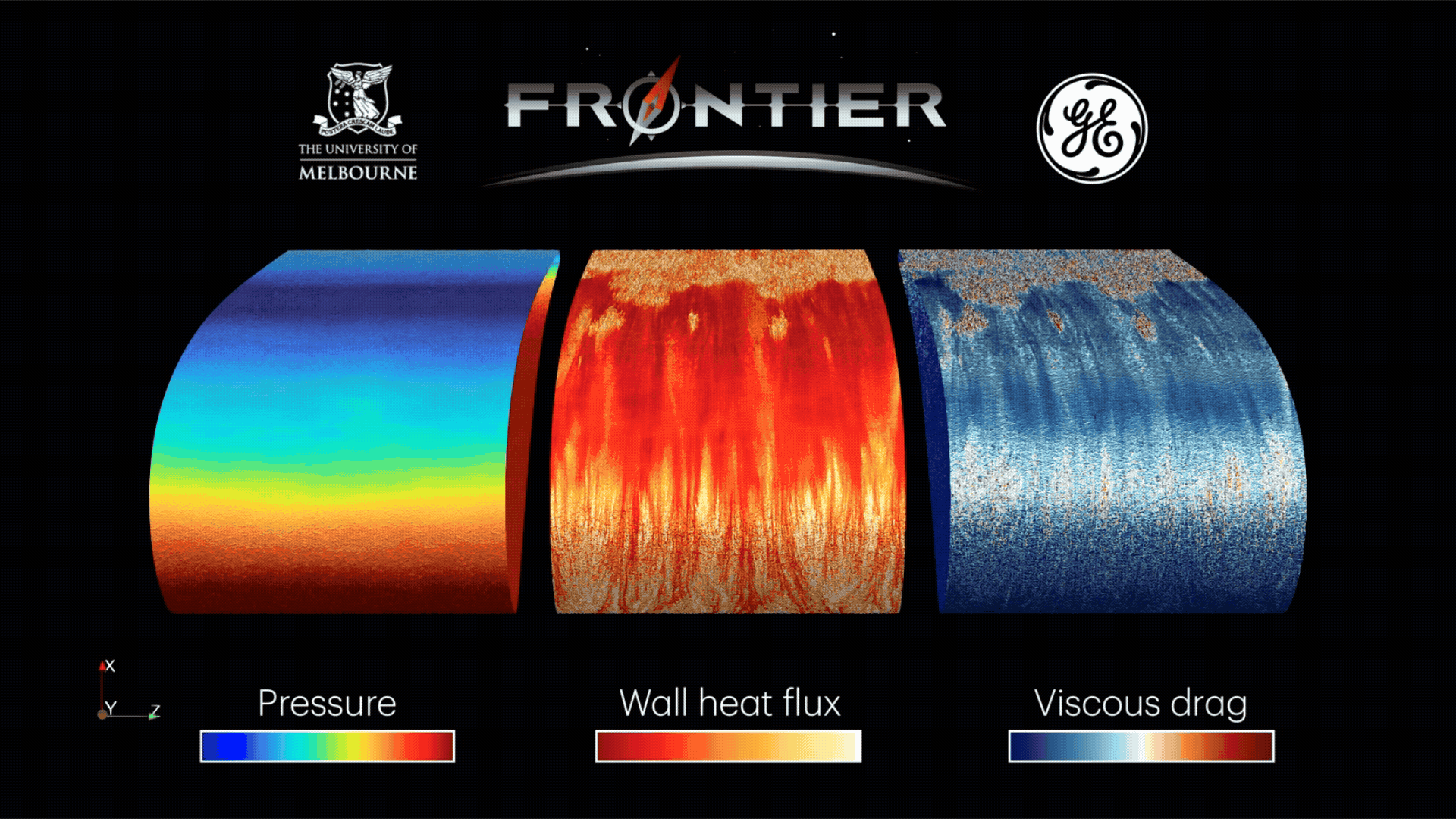

This animation shows suction-surface transition mechanisms on a high-pressure turbine vane with microscale surface roughness, including instantaneous pressure (left), wall-heat flux (middle), and viscous drag (right). Credit: Thomas Jelly, University of Melbourne

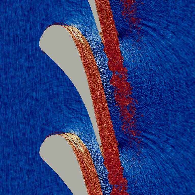

Flow past HPT vane with micron-scale surface roughness at Reynolds number = 590,000 and Mach number = 0.92. Data include instantaneous density gradient (blue) and instantaneous vortical structures (red iso-volumes). Credit: Thomas Jelly, University of Melbourne

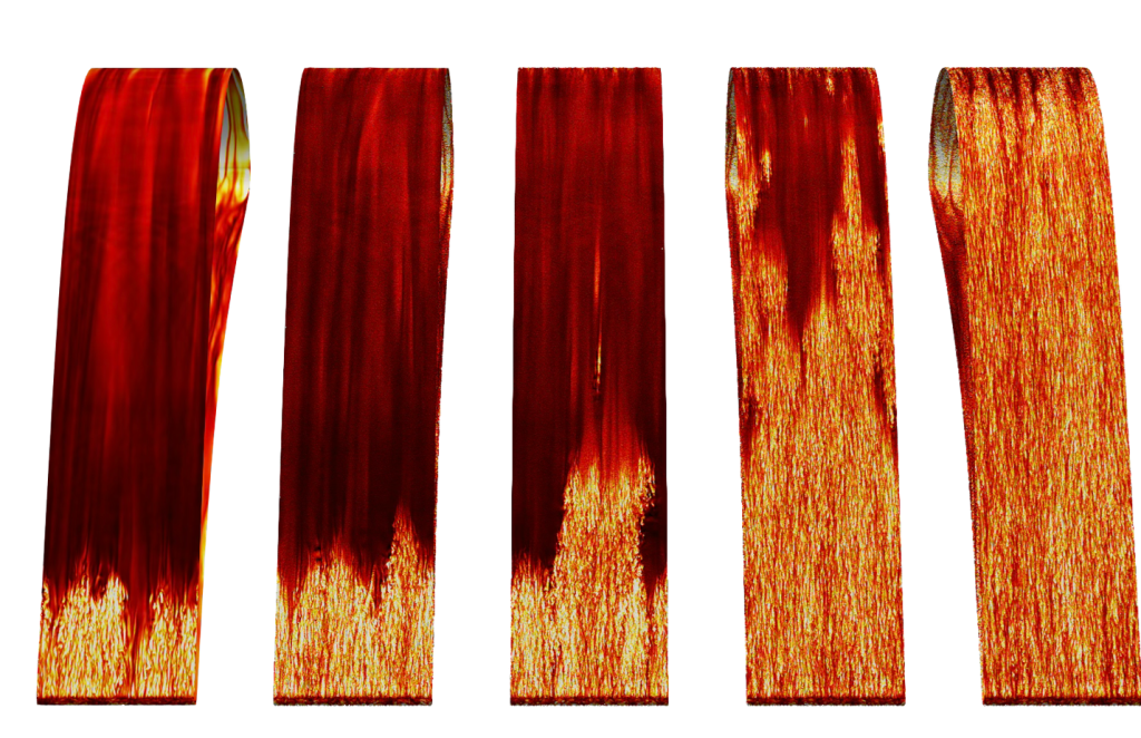

This visualization shows the instantaneous wall heat flux on the suction surface of turbine blades in a high-pressure turbine engine. The levels of surface roughness in the leading-edge region are increasing from left to right. Credit: Thomas Jelly, University of Melbourne
