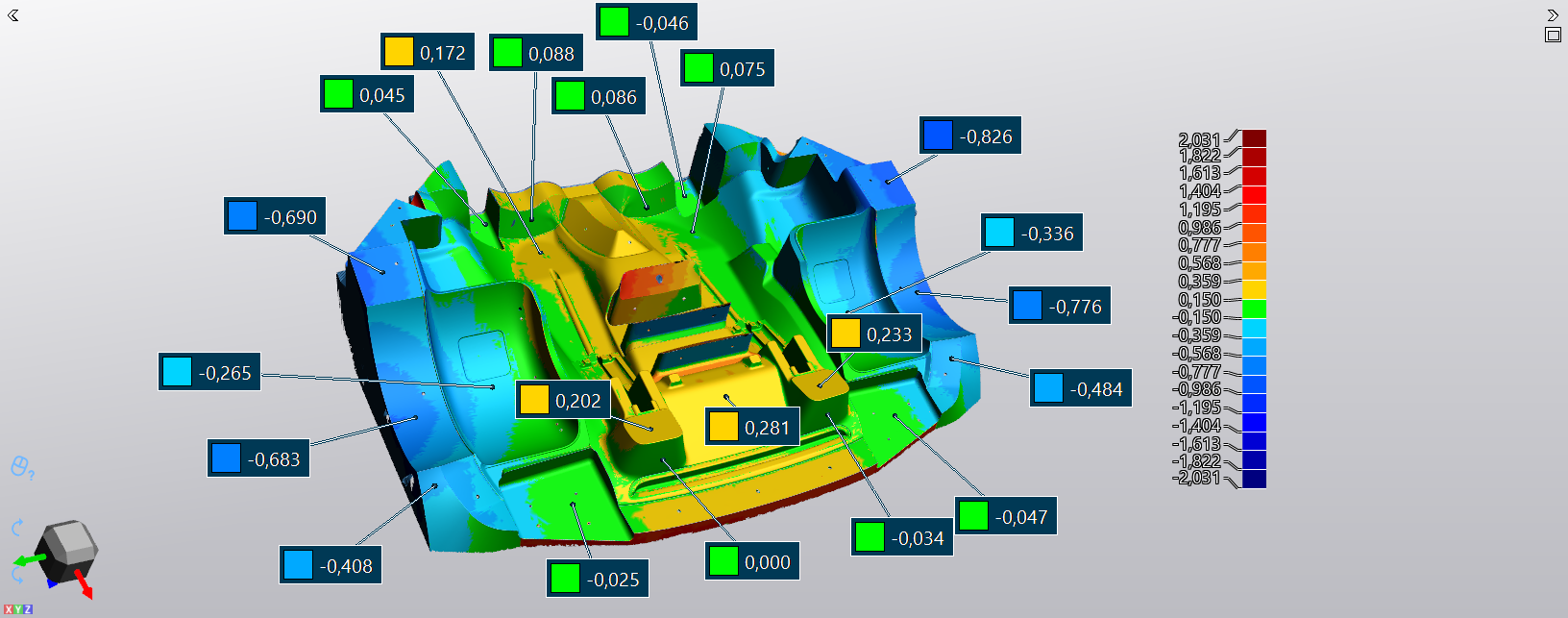

FARO CREAFORM Metrology Suite software visualizes the rear hood of a Formula 1 race car.

As anticipated, the upgrade to the HandySCAN 3D scanner delivered immediate and tangible benefits in multiple dimensions.
Dramatic reduction in preparation time: The near elimination of scanning spray significantly reduced setup time. Nonadhesive targets further streamlined the process, minimizing prescan preparation and postprocessing cleanup.
Increased measurement speed: With an improved field of view and faster acquisition rates compared to earlier models, the system enabled rapid scanning of complex geometries, accelerating inspection cycles.
Enhanced workflow efficiency: Reduced manual intervention allowed quality control teams to handle higher volumes without additional resources. The risk of bottlenecks during large-scale projects was effectively mitigated.
Improved data quality and reliability: Accurate capture of fine details, including small threads, enhanced overall inspection fidelity, and supported better decision-making and product quality.
