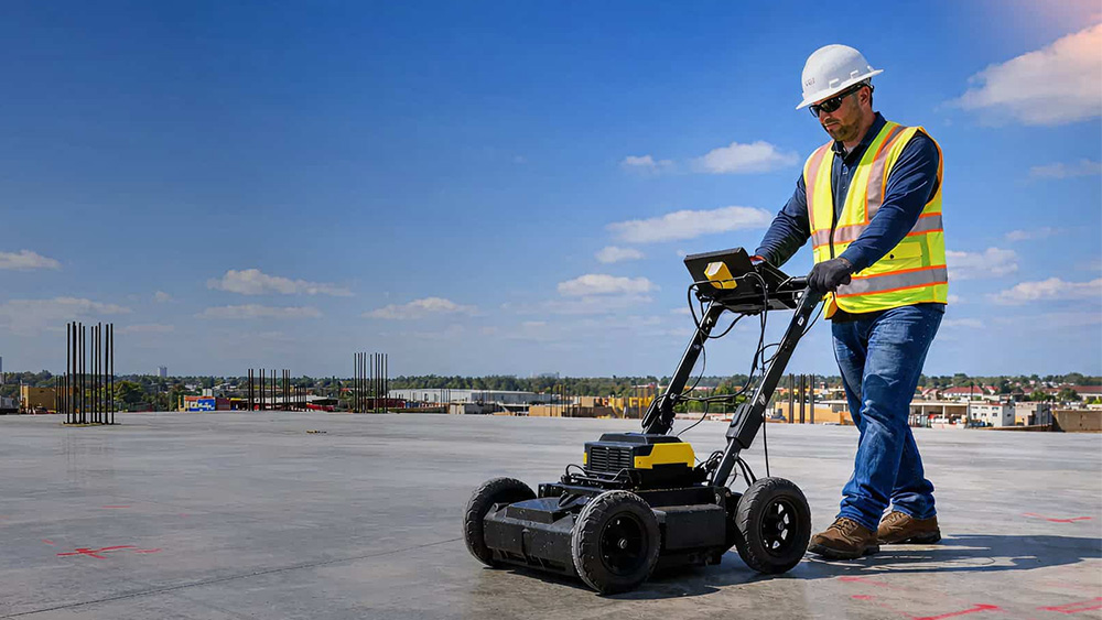

Electromagnetic locating can be very effective when a conductive utility can be traced, or when a signal can be applied to it.
In other situations, GPR scanning could help identify subsurface features that can’t be traced electromagnetically.
But GPR isn’t an underground X-ray. Conditions matter. Soil composition, moisture, target depth, congestion, accessibility, and the materials involved can all affect the response.
Sometimes the result is clear. Sometimes it’s not. That’s normal field work.
The better approach is often to combine information instead of expecting one instrument to settle every question.
An electromagnetic locator could establish a strong trace on one service. Radar might add information about other features nearby. A manhole, riser, valve, or utility box may explain where a line is likely to continue. Existing plans can provide another clue.
A useful subsurface-utility mapping process builds the picture from those pieces of evidence.

A radar unit can show a response. The technician still has to determine what that response might mean.
It might be a utility. It could also be buried debris, an old structure, a change in soil conditions, or something else entirely.
That’s why interpretation matters. Does the response continue in a logical direction? Does it connect with something visible? Can it be supported with electromagnetic locating? Does its apparent route agree with other information on the site?
