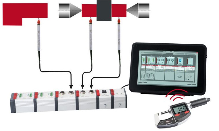

As production tolerances become ever tighter, and the error margin for measurement results constantly shrinks, temperature fluctuation is an issue that users may need to consider in their inspection process.
The background to this is a natural physical phenomenon: Most materials expand when heated and contract when cooled. Because the aim of a test procedure in production metrology is to determine the actual size of a workpiece, the fact that it can be a different size at various temperatures must be considered.
Although a basis for standardizing temperature measurement for calibration has been around since the 1930s, in a real-world manufacturing setting this often doesn’t happen. Companies specializing in high-accuracy precision work will make the effort to create environmentally controlled rooms or even plants for this purpose. But in some areas, this hasn’t yet been considered.
The other way to start correcting these errors is to consider implementing measuring systems to monitor the temperature of the workpiece and correct the measured values.

This article discusses technology that was not available in 1930, namely the ability of computers to compensate for thermal expansions of both the part and the gauge when measurements cannot be performed in a climate-controlled lab. Even if a climate-controlled lab is available, it doesn't help when "Workpieces that have just come out of a dry machining process can be several degrees warmer and remain so for hours." If we have to wait several hours for them to cool down, that's wasted cycle time (waiting). Ford got around similar issues by sending specimens to a lab (for metallurgical tests as I recall) while a lot was being processed, i.e. the work did not wait but would be stopped only if the specimens were out of specification, but this doesn't work when all the parts have to be measured before they can go to the next operation.  If temperature compensation can be done at the point of inspection, though, this eliminates the problem completely.
